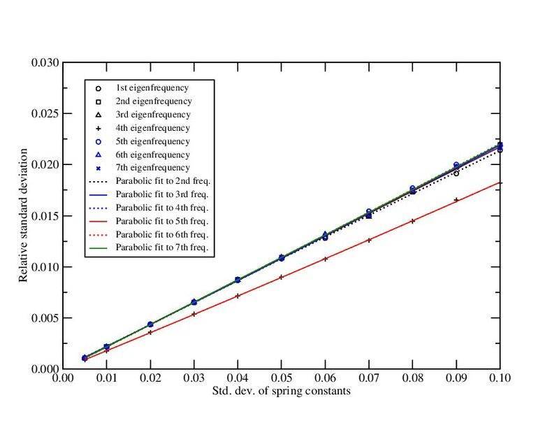

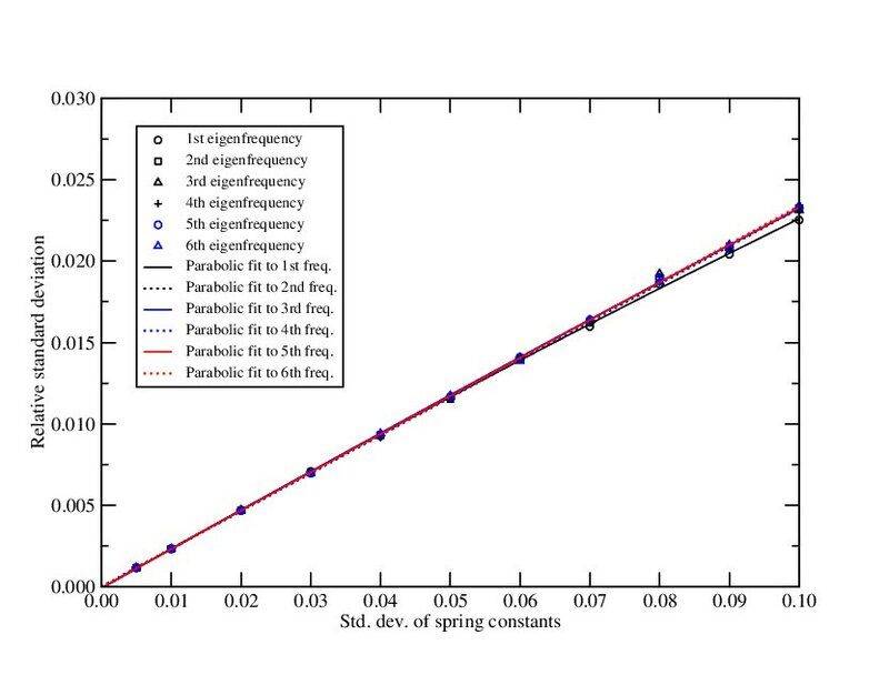

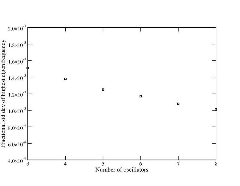

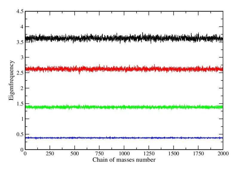

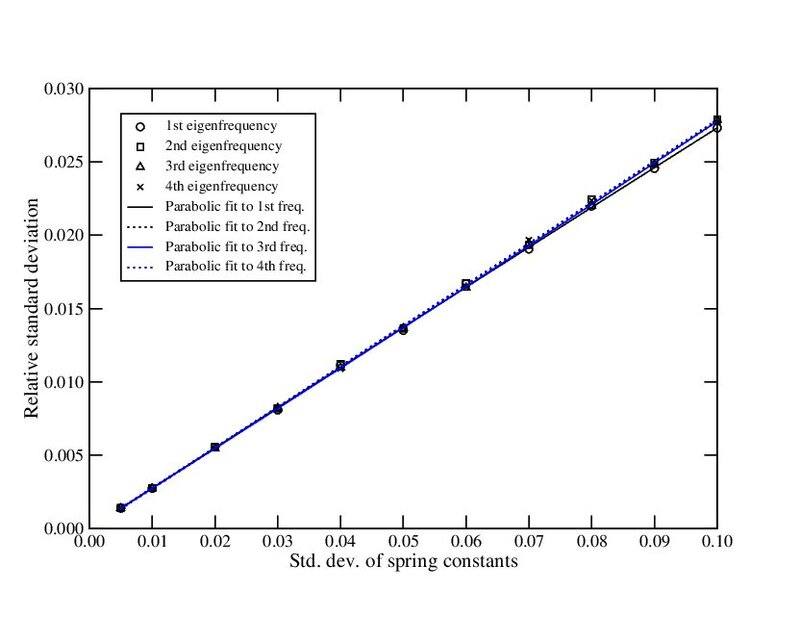

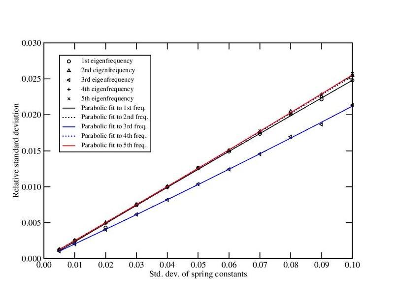

- Making a coupled oscillator system with a stable eigenfrequency for timekeeping purpose.
If a Hookean spring-mass system is made from one mass and a spring, to produce a system with a particular oscillation frequency, it's not a problem to use the propagation of errors concept to find how this frequency responds to small errors in the mass and spring constant. If a chain of oscillators with similar masses and springs (from same supplier) is used instead, any random errors in the masses and ##k##:s should cancel out the better the more masses there are in the chain.
I haven't yet calculated how systematic errors in the spring constants (such as from wearing out with time) affect the eigenfrequencies of a coupled oscillator system, but this would be useful when making a mechanical clock with a timekeeping frequency that remains more constant despite springs becoming more or less stiff than before in long-term use. I would expect that some normal modes are more resilient in this sense than others, and some coupled systems could be better than just a simple linear chain with two springs connected to each mass. Have any of you seen this idea anywhere, before? I'm not sure what to call this in a Google search, but writing "stable oscillator normal mode" as search terms didn't return anything obviously related to this. The problem is clearly related to the stability of the eigenvalues of the matrix in the equation of motion, when small perturbations are added.
