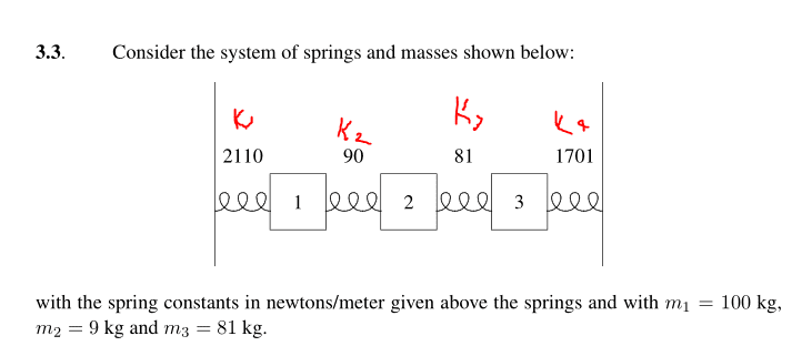

We need to find the normal modes of this system:
Diagram of a horizontal chain of three masses between two walls, joined by four springs labelled k1 = 2110, k2 = 90, k3 = 81 and k4 = 1701 in N/m, with blocks labelled 1, 2 and 3.
Well, this system is a little easy to deal when we put it in a system and solve the system... That's not what i want to do, i want to try my direct matrix methods.
We have springs with stiffness k1,k2,k3,k4 respectively, and block mass m1, m2, m3

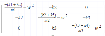

And we need to annul the determinant of
Matrix equation det(M^-1 K - W^2) with M inverse times K minus W squared, written as a determinant expression for finding normal mode angular frequencies.
, not just, i supposed the displacement Z as complex, so we need real angular frequencies.
To mount the matrix K, we need to know all Kij, being Kij the spring stiffness equivalent if we move just block j and analyze the motion of block i, j can be equal i.
So making all the things, we end with:
3x3 determinant matrix with diagonal entries -(k1+k2)/m1 - w^2, -(k2+k3)/m2 - w^2, -(k3+k4)/m3 - w^2; off-diagonal entries -k2 and -k3; zeros elsewhere.
Apparently this is wrong, i found just complex w, what is the problem?

Try the same method on a much simpler arrangement, one you can easily check from first principles. Note where the signs disagree.
Yeh that's enough... thank
