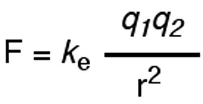

So the formula for the coulomb force is
Therefore the force between 2 Protons at 5 femtometers is 9.24N, I guess you're right it is unlikely that there could be any net energy gain of this

This is a faulty understanding. Firstly, 1 MeV is a measure of energy, not force. Secondly, one can determine the energy needed by integrating force over distance applied. Thirdly, force or pressure is quite high - take the force applied between two protons, which would be the same as between two deuterons or a deuteron-triton pair at the same distance, but now multiply by 1014, and see what pressures are involved.
