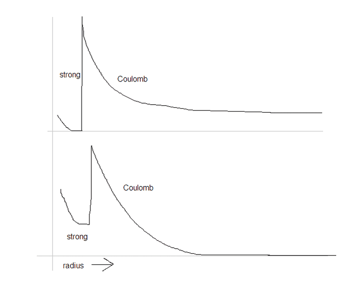

Thanks. I have a couple more questions. First, a quote from Resnick and Halliday's 'Fundamentals of Physics'.
"It takes a few eV to remove an electron from an atom, but it takes a few million eV to remove a nucleon. That is why nuclear fusion releases so much more energy than chemical reactions."
My question is, if the strong force is only about a 100 times stronger than the EM force why does it take so much energy to separate a nucleon?
And secondly, if uranium nucleus is unstable because the EM force beats the strong force due to the strong force's short range, why doesn't the nucleus fly apart immediately? Why do we need bombard it with a neutron to accelerate the process? I would think that work was done to bring it into this position, so as soon as the work is removed the nucleus should fly apart.
In a heavy nucleus, the strong force is still stronger than the Coulomb force, but the strong potential is weaker than the Coulomb potential. The potential is the force integrated over distance, and the Coulomb force acts over a longer distance. It's energetically favorable for an alpha particle (a helium-4 nucleus) to escape from a uranium nucleus, but it has to first get over a large activation energy.
In the picture, the top represents the potential of a stable nucleus. The nucleons are trapped in the well on the left, which is the strong potential. The bottom represents and unstable nucleus. The nucleons are somewhat trapped by the strong potential, but they can sometimes tunnel out and release stored Coulomb energy.
Chemical reactions only involve electrons and nuclei. The Coulomb force between the electron and the nucleus is much weaker than the Coulomb force between two protons in the nucleus, which is still weaker than the strong force in many scenarios.

Ok great. So here's a final picture. When two light nuclei fuse, their electromagnetic potential increases but their strong nuclear potential decreases much more rapidly, releasing a lot of stored energy. For an unstable nucleus, although the strong force is stronger if an activation energy is overcome then when the nucleus splits the electromagnetic potential decreases much faster than the strong potential increases, hence releasing energy. Nuclei like uranium can still however be formed, because though it takes energy to form the nucleus(strong potential doesn't decrease as fast as electromagnetic potential increases) and there is no energy release after the formation of the nucleus, the strong force is still stronger than the em force and holds the nucleus together.
