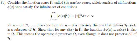

See the attachment
integrate from negative infinity to infinity ∫|f(x)|[SUP]2[/SUP]dx is finite
If I understand this question correctly, I am supposed to prove an integrate from negative infinity to infinity ∫x|∅(x)|2(1+|x|)ndx is finite. Sorry, but I have no idea.
Your understanding of what you need to do is correct. (proving for all n, of course). Remember, the premise is that you already know
∫|∅(x)|^2(1+|x|)^n dx
is finite for all n. What can you do to to get that x out of the integral and relate it to the integrals you already know are finite?

TTT said:
I have tried to do this with integrating it by parts, but it did not go well. Are you suggesting something else?
This is more like a real analysis problem. Note that the integrand is non-negative in all cases. I suggest you look for a suitable inequality that bounds the integrand when you have the ##x^2## in it. In other words, you need to find an inequality:
##x^2|\phi(x)|^2(1 + |x|)^n \le f(x)##
Where ##f(x)## is some function you know is integrable. The result then follows from the properties of the integral.
Note: if you haven't studied any real analysis, then the approach to problems like this will be hard to find.
Almost. You're supposed to show that
$$\int_{-\infty}^\infty \lvert \hat x \phi \rvert^2 (1+\lvert x \rvert)^n\,dx = \int_{-\infty}^\infty |x|^2 \lvert \phi \rvert^2 (1+\lvert x \rvert)^n\,dx$$ is finite.
I suggest you try expressing ##\lvert x \rvert^2## as a linear combination of powers of ##1+\lvert x \rvert##.
$$\lvert x\rvert^2\le(1+\lvert x\rvert)^2$$
So
$$\int_{-\infty}^\infty \lvert x\rvert^2 \lvert \phi \rvert^2 (1+\lvert x \rvert)^n dx\le \int_{-\infty}^\infty \lvert \phi \rvert^2 (1+\lvert x \rvert)^{n+2}dx$$
