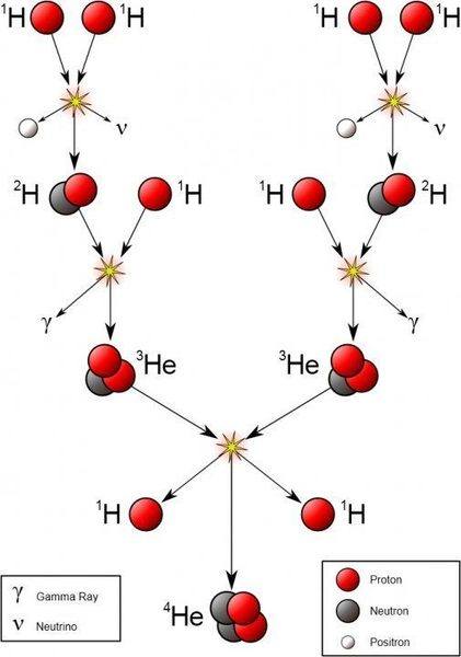

Actually I want to know how the sun (and the stars) gets its energy.
If it's proton to proton reaction chain, then...
[itex]{^{1}_{1}H} + {^{1}_{1}H} = {^{1}_{2}D} + p^+[/itex]
[itex]{^{1}_{2}D} + {^{1}_{1}H} = {^{2}_{3}He}[/itex]
[itex]{^{2}_{3}He} + {^{2}_{3}He} = {^{2}_{4}He} + 2{^{1}_{1}H}[/itex]
This reaction seems involve 6 Hydrogens atom. And 6 electrons?
And the result only have 4 electrons?

Stephanus said:
Thank you, thank you for the answers.
This belongs to other thread I guess
And the result if neutrally charged only have 4 electrons?
But I'd like to know first before I learn nuclear reaction.
Is the universe (approximately) neutrally balance?
Okay..., I'd like to study your answers first.
Thanks.

Also an addition to the chain you wrote down...
There are no electrons shown in those reactions, but nuclei... The circumstances where these reactions occur don't allow for atoms to exist, instead you are having a plasma state (ionized elements). Rephrasing: the electrons and nuclei are free.
And H+H-> D+p doesn't make much sense.
ChrisVer said:
...instead you are having a plasma state (ionized elements)...
Double foolish I am!. Forgot that also!
Okay..., nucleus' and electrons are free roaming. But the universe is somewhat electrically charge balance, right?
But, that's what Wikipedia says
Check post#2, stating that probably it is neutral... altough I'm not sure why would that be the case, and I don't know of anyway we'd measure the charge of the universe.
If you want to see the charge conservation (since it's conserved) then the electrons are free around and they meet a positron (which I mistook as a proton with that notation as Chalnoth said) coming from the 1st line and annihilate.
