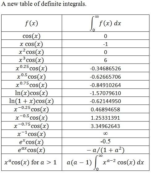

Trying that again with equations, and with nonlinearity added to the end.
Here's how the numerical solution of an oscillating divergent integral in QM might work. Equal intervals are used but are not an essential part of the solution method. The first is a toy problem, far too simplistic.
Solve $$\int_{-\infty}^\infty e^{i(x_1^2+...+x_7^2)}dx_1...dx_7$$
The real part equals $$2\int_0^\infty \cos(x_1^2+...+x_7^2)\,dx_1...dx_7$$
Convert to hyperspherical coordinates, that equals $$2S_7\int_0^\infty r^6\cos(r^2)\,dr$$
where $$S_7= 16\pi^3/15$$ is the surface ofr a 7-ball with unit radius.
Substitute $$y=r^2$$ to get the integral component
$$\int_0^\infty y^{2.5}\cos(y)dy$$
To solve this divergent oscillating integral numerically, start by integrating by parts on a finite domain.
$$\int_0^x y^{2.5}\cos(y)dy=x^{2.5}\sin(x)+2.5x^{1.5}\cos(x)-\frac{15}{4}x^{0.5}\sin(x)+\frac{15}{8}\int_0^xy^{-0.5}\sin(y)dy$$
Here's where the study of infinite numbers comes in. It's OK to redefine the infinite limit of a pure oscillating function to be equal to zero. Examples of pure oscillating functions include $$f(x)\cos(g(x))$$ for a range of non-oscillating functions f and g including non-negative powers, finite polynomials, exponential and logarithmic functions. So
$$\lim_{x\to\infty}(x^{2.5}\sin(x)+2.5x^{1.5}\cos(x)-\frac{15}{4}x^{0.5}\sin(x))=0$$
and
$$\int_0^\infty y^{2.5}\cos(y)\,dy=\frac{15}{8}\int_0^\infty y^{-0.5}\sin(y)\,dy$$
The integral on the right hand side is oscillating convergent, so can be directly solved numerically. For faster numerical convergence, do the direct integral only from 0 to π and carry out two more applications of integration by parts to get the term $$\int_{\pi}^{\infty}y^{-2.5}\sin(y)\,dy$$
This can, of course, all be considered moot because the original integral has an analytic solution. But my hope is that a similar numerical method can be used for oscillating integrals when no analytic solution is available.
A word of warning. In general,
$$\lim_{x\to\infty}\frac{\int^xA}{\int^xB}\ne\frac{\int^\infty A}{\int^\infty B}$$
When calculatating expected values, the left hand side must be used not the right hand side.

Got it. I said before that I wanted to be able to numerically integrate the path integral
$$I=\int_{-\infty}^\infty e^{i((x_1-1)^2+(x_2-x_1)^2+(x_3-x_2)^2+(x_4-x_3)^2+(x_5-x_4)^2+(x_6-x_5)^2+(x_7-x_6)^2+(1-x_7)^2+\sum_{n=1}^7p(x_n))}\,dx_1dx_2...dx_7$$
Write this as
$$I=\int_{-\infty}^\infty e^{iq}\,dx_1dx_2...dx_7$$
The antisymmertic parts of $q$ don't contribute to $I$ so can be omitted, leaving
$$I=\int_{-\infty}^\infty e^{i(2+\sum_{n=1}^7(2x_n^2+p(x_n)))}\,dx_1dx_2...dx_7$$
This is separable, giving
$$I=e^{2i}(\int_{-\infty}^\infty e^{i(2x^2+p(x))}\,dx)^7$$
Only an integral in 1-D is needed. Change variable using $y=2x^2+p(x)$ to give
$$\int_{-\infty}^\infty e^{i(2x^2+p(x))}\,dx=2\int_0^\infty e^{iy}(dx/dy)dy$$
Here for simple $p(x)$ the formula for $dx/dy$ can be found analytically and for messy $p(x)$ the formula for $dx/dy$ can be found numerically. This then resolves to the case of the nonlinear oscillator described above and the same methods are used. In a nutshell, keep integrating by parts until the oscillations are suppressed enough to get an accurate answer using standard quadrature methods. The differentials for the integral by parts $$d^2x/dy^2,\,d^3x/dy^3$$ etc. can be evaluated either analytically or numerically, depending on the original $p(x)$.
This method also goes a long way towards solving the more general integral
$$ \int_{-\infty}^\infty f(\mathbf{x})e^{ig(\mathbf{x})}\,d\mathbf{x}$$
when $f(\mathbf{x})$ is separable and $g(\mathbf{x})$ does not contain symmetric cross correlations such as $x^2y^2$.
Here, it's $f(x)(dx/dy)$ that is differentiated again for each iteration of integration by parts.

Some results, a mix of theoretical and numerical evaluations of the integral of g(x) cos(x) over the interval 0 to infinity, give the following table of integrals. You won't find this table anywhere else on the web. Accuracy of the numerical evaluations is not guaranteed, particularly in the last decimal place.
Most of your integrals are not even well-defined, so it is not surprising they are not listed anywhere.
The others are easy to get with the usual tools. Sometimes even analytically.
