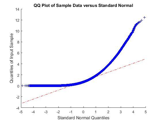

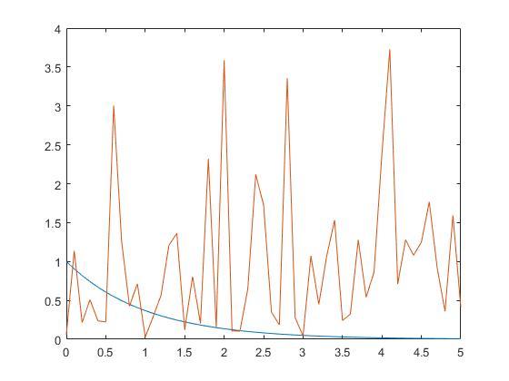

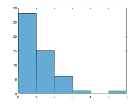

I tried to check the generator. But after I draw the exponential distribution for an exponential random variable with mean 1, I didn't know how to generate the exponential random variables and match them to the numerical result. I wrote the following:
Code:
x=0:0.1:5;
y=exp(-x);
ySim=exprnd(1,1,length(x));%This generates an 1-by-length(x) array of exponential random variables of mean 1
plot(x,y,x,ySim);
I got the results attached. I think I didn't do it right, did I?

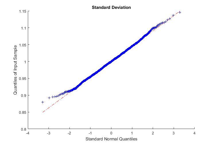

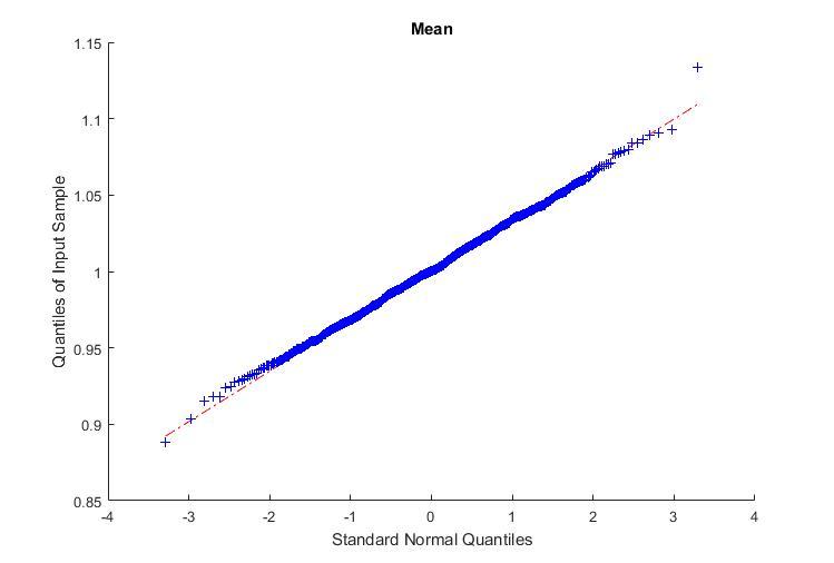

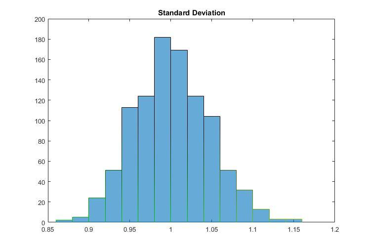

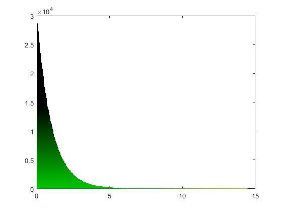

You will want to plot the random data using either a histogram or a qq plot.
The histogram will probably look pretty good, but the qq plot will be more sensitive to deviations.
How can I do it with the histogram? I have the exponential random variables in ySim.
I don't know Matlab, I use Mathematica and R. I would think that Matlab has commands for plotting histograms and qq plots, but I cannot tell you their syntax.
