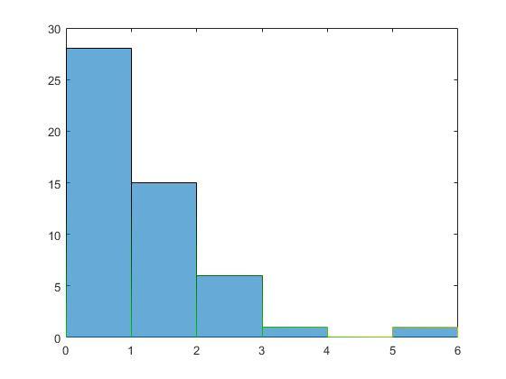

It's histogram(x). When I used with the data I have, I got the attached figure. Does that make sense?
  • MATLAB histogram with bars at bin edges 0 to 6 in unit-width bins, counts roughly 28, 15, 6, 1, 0, 1 in the bins from 0 to 1 up to 5 to 6, y-axis from 0 to 30.
Yes, that seems right. Notice how it does not go out to infinity and how it is not strictly monotonically decreasing. The variations are small, but they will make a difference in achieving a given level of numerical precision.
Can I do anything about it? I'm writing a scientific journal, do you think such justification is acceptable for why there is a difference between the two curves?
Hmm, OK, if you are writing a scientific paper then you want to hold your work to a higher standard. Let's look at a couple more things.

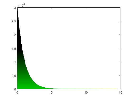

In the first figure, I didn't generate ##10^6## samples. In the attached figure I did. Does this change anything before going to implement your suggestion?
  • MATLAB histogram of a decaying exponential-shaped distribution: bars fall from about 3x10^4 at x=0 to near zero by x=6, with x-axis from 0 to 15 and a green-to-black gradient fill.
No. It still shows the same key features, but it is smaller and harder to see. The range is not infinite and the curve is not smooth. This is to be expected in any random number generator, but it is a source of numerical error.
If we are lucky then the sampling distribution will show some small bias.

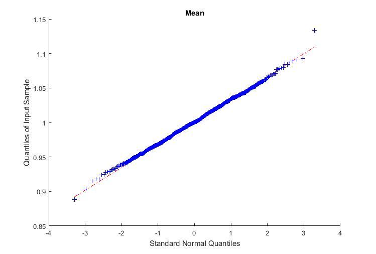

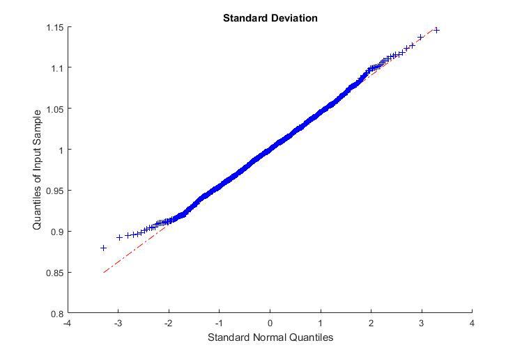

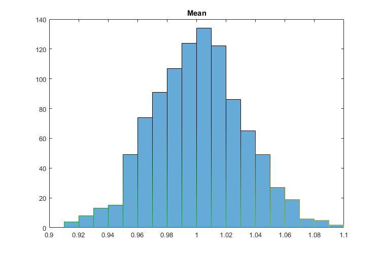

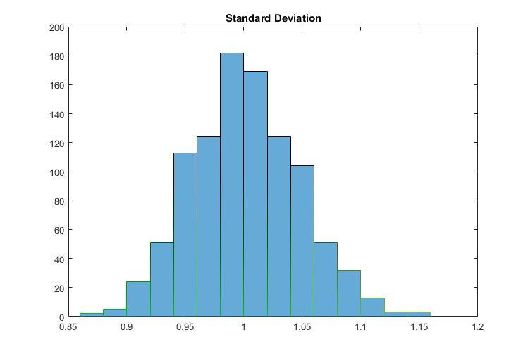

OK, I did your suggestion, and got the attached figures for the mean and standard deviation. What can we infer from this?

  • Histogram titled Standard Deviation, bell-shaped, peaking near 1.0 with about 180 counts, ranging roughly from 0.86 to 1.16 on the x-axis and 0 to 200 counts on the y-axis.
Also attached are the qq plot for the means and standard deviations calculated above

So it looks like the RNG is not too bad but the sampling distribution does show a bit heavier tails than normal and a bit of right skew.
Can you do a qq plot of the ySim against the exponential distribution instead of the normal distribution?
Also, what is the mean and standard deviation of the sampling distribution of the mean?

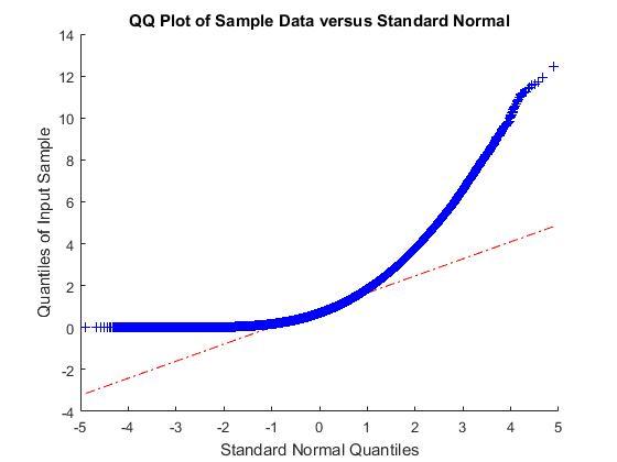

I didn't understand your questions. For Q1: What do you mean by qq plotting ySim against the exponential distribution? and how? I qq plot ySim alone and got the attached figure.
I also didn't understand Q2. Sorry, but can you elaborate, please.
  • QQ plot titled "QQ Plot of Sample Data versus Standard Normal": blue points on a flat run near 0 for quantiles from -5 to about -2, then curving steeply upward to about 12 at quantile 5, above a red dash-dot reference line.
OK, for Q2: the mean and the standard deviation of the mean are 1.0001 and 0.0309, respectively.
OK, that is essentially unbiased.

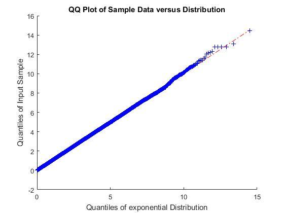

So the qq plots you have posted so far plot against the normal distribution. The ySim values are not normally distributed so the qq plot should be done against the exponential distribution.
Right. I did it, and got the attached figure.
  • QQ plot of sample data against an exponential distribution, with blue crosses lying close to a red dashed reference line; the upper tail departs slightly above the line at the largest quantiles.
Good. Do you see the deviations on the upper right and how there is some discrete steps where there are 4 points with the same vertical position? The errors from that are not well characterized. So I think you can justify not using the Monte Carlo.
It appears that there is not much, if any, bias in the sampling distribution, but the asymmetric numerical errors make those results suspicious.
