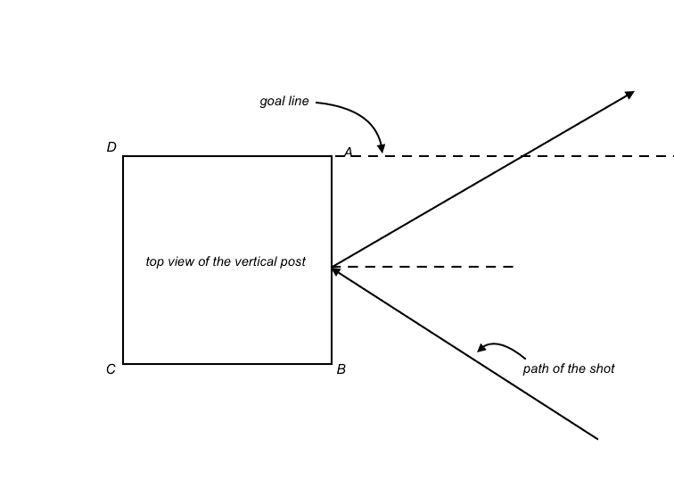

First let's talk about the square post,
it is clear that the shot will go in only if the ball hits the side AB of the square shown below, so the probability of a shot going in is simply ##\frac 1 3## as sides AB, BC & CD are equivalent and only hitting one of these 3 sides leads to a goal.

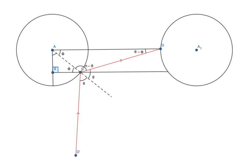

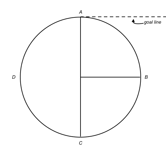

Now the interesting case of circular goal post,
In the figure below (top view of the goal post), any shot hitting the sector ADC will never go in, any shot hitting sector AB will always go in and any shot hitting sector BC will go in only when the angle of incidence is greater than the critical value. The critical value of angle of incidence happens when the reflected ray from the sector BC of one post hits the sector AB of the other post.

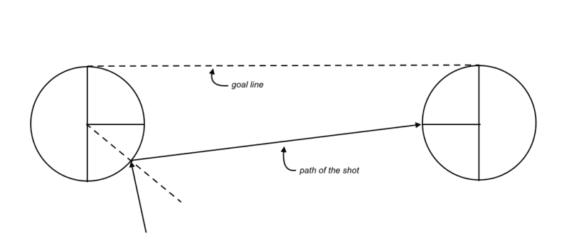

Limiting/critical incidence,
So now all we have to do is find the range of all the values of angle of incidence ##\theta## in sector BC for which the shot goes in i.e., [##\theta_{critial}##,##\frac \pi 2##] and then divide that by range of all permit-able values of ##\theta## i.e., [0,##\frac \pi 2##]
The problem is that this range of possible values of ##\theta## changes at every point on sector BC. And even though the length between posts and the radius of the posts are fixed, the value of ##\phi## (shown below) changes from [0,##\frac \pi 2##]
Now we can get a relation between ##\phi## & ##\theta## using sine law in ∆ADC,
$$ {\frac {\sin(\theta-\phi)} {AC}}={\frac {\sin(\pi-\theta)} {AD}}$$
here AC & AD are known (radius & distances between the posts respectively) and are constant but ##\theta## & ##\phi## are both variables
So that is my question, I want to find the critical value of ##\theta## for every value of ##\phi \in [0, \frac \pi 2]## i.e., first I want to individually calculate the probability of a shot going in for a particular value of ##\phi## then I'll add all the probabilities for every value of ##\phi \in [0, \frac \pi 2]##
So somehow I need to find,
$$\sum_{\phi=0}^\frac \pi 2 (\frac \pi 2 - \theta_{critical})$$
but the value of ##\theta## is non-linear and I don't know how to find that summation.
I don't know if this is the right way to do this or if there is any way of doing this?
it is clear that the shot will go in only if the ball hits the side AB of the square shown below, so the probability of a shot going in is simply 13 as sides AB, BC & CD are equivalent and only hitting one of these 3 sides leads to a goal.
There are a lot of things wrong with this reasoning. First of all, the basic assumption is incomplete. Whether the ball goes into the net or not is going to depend on the angle that the ball hits in and therefore on the distribution of balls coming in at each angle. Furthermore, hitting a side is not the only way of hitting a square post, there is also going to be some probability of hitting one of the corners without actually hitting the sides.
Similar arguments are valid for the circular goal posts, there are many unknowns that you'll need to specify distributions for and you'll need to specify how the posts are to be compared.

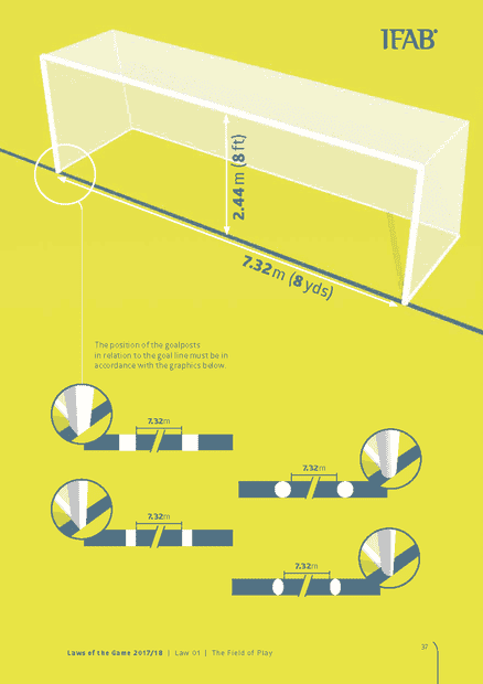

It hardly matters since the posts these days are officially elliptical!
https://www.fourfourtwo.com/features/weird-and-wonderful-history-goal-posts
The square designs were eventually banned by FIFA in 1987, and the round version has also been gradually replaced by an elliptical shape created by the Standard Goals Company in Nottingham.
If that is true then they must have subsequently been unbanned: from the 2020/21 IFAB Laws of the Game:
10 Goals... [The goalposts and crossbar] must be square, rectangular, round, elliptical or a combination of these shapes and must not be dangerous...
