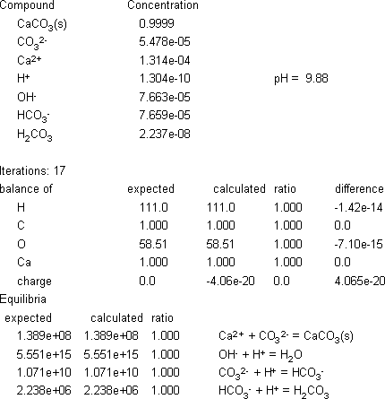

and
CO32- + H2O <-> HCO3- + OH-
When you take water autodissociation into account, this is in fact the same equilibrium (that's what Brønsted-Lowry theory is about). Acid dissociation constant for the first reaction is
[tex]K_{a2} = \frac {[H^+][CO_3^{2-}]} {[HCO_3^-]}[/tex]
base dissociation constant for the second is
[tex]K_{b1} = \frac {[HCO_3^-][OH^-]} {[CO_3^{2-}]}[/tex]
(water concentration is assumed to be constant and ignored by convention)
and
[tex]K_{a2} K_{b1} = K_w[/tex]
where Kw is water ionization constant.
The situation is further complicated by all the other ions p[resent in seawater.
Yes, but we can ignore them for now to make sure we talk about the same system.
Also these equations carry the reason for the buffering at pH = 8.8 and again at pH = 4.5, which was the other question asked about my posts.
I can't see it, please elaborate. Carbonates have a significant buffering effect at pH around 6.37 (pKa1) and 10.25 (pKa2). See attached image. This is a plot of a carbonate buffer capacity, horizontal scale is pH, black arrow points at pH 8.8 (where buffering capacity is relatively low). For low pH this plot assumes high pressure of carbon dioxide, but it is irrelevant in the range we are talking about.

Explanation to the image with calculation results: first, there is a list of substances present and their equilibrium concentrations (don't pay attention to concentration of CaCO3(s), it is just lousy reporting of calculation results for solids). Things below are just to check if the numerical result is correct. Balances of mass and charge show numbers of moles of each element expected in 1L of solution, differences are just rounding errors. Then comes list of equilibria given for the system - these are same 4 I have listed in my previous post. Equilibrium constants are given for reactions as written on the right, so these are not dissociation constants but protonation constants, which are just reciprocals. Water dissociation constant is not 1e-14, as for mass balances I had to take water presence into account, that in turn means Kw is not just [H+][OH-] but [H+][OH-]/[H2O]. But these are just technical minor points, related to implementation, system and model used is exactly as described in my previous post.
