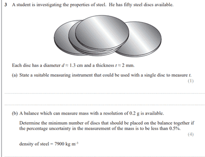

problem statemetn below
volume = surface area of sphere * thickness
percentage uncertainty = absolute uncertainty/ value
244275
should n't it be a maximum number to achieve less than 0.5% uncertainty for the last question as you add more disks would there not be more uncertanity therefore as the number of disks for 0.5% is 9.5, 10 would give an unceranity of greater than 0.5% so it should be 9? the answer is 10.

Exam broad,, for a levels . IF you got free time friend would be grateful if you could help me out.
An implicit assumption going in is that the discs are identical.
The uncertainty is from the limited resolution of the scale: 0.2 grams. As specified, the scale's resolution is independent of how many discs you pile on. The more you pile on, the lower the uncertainty per disk.
