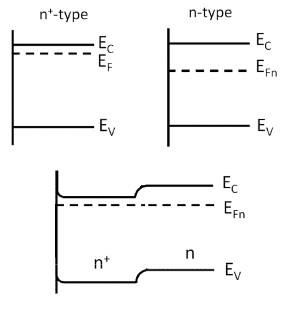

Hello Every body!
As shown in below, If i join a heavily doped n+ semiconductor with an ordinary n-type semiconductor,
What is the type of contact that forms between n+and n-type semiconductors ?
is it Ohmic contact or rectifying contact ??
it's Ohmic.
