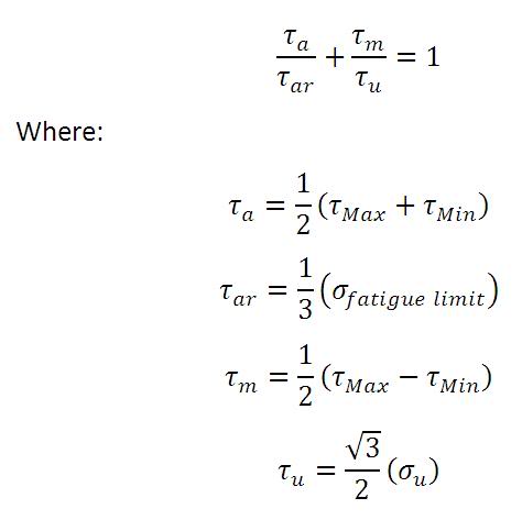

I don't quite understand how the modified goodman equation can be applied to a multiaxial stress state. The explanation given in my stress analysis class has been quite confusing and verbose so I've come here to see if I can't get a better understanding.
First I'll lay out what I think to be true:
Utilizing the Von-Mises failure criterion in place of the uni-axial stresses in the goodman equation should be able to account for a multiaxial stress state AND fatigue. Here's how I think it should work
Uni-axial stress amplitude is replaced with von-mises stress amplitude (same equation, different stresses)
The fatigue limit at whatever number of cycles the designer is concerned with is replaced with the Von-Mises stress at that stress amplitude. Or: (Uni-Axial Fatigue limit at X cycles)*(1/3)=fully reversed stress amplitude (or SIGMAar in the good man equation).
Mean stress is replaced with mean von-mises stress (same equation, different stresses)
Ultimate stress is replaced with (sqrt(2)/3)*SIGMA(u) or the von mises stress at failure.
Equations:
That last equation should be sqrt(2)/3. Made a mistake when writing the equations. Thanks.
Is this correct?
Actually you got the equations for stress amplitude (tau_a) and mean stress (tau_m) swapped, here.
Whitebread wrote:[/color] "Utilizing the von Mises failure criterion in place of the uniaxial stresses in the [modified] Goodman equation should be able to account for a multiaxial stress state and fatigue. Here's how I think it should work. Uniaxial stress amplitude is replaced with von Mises stress amplitude."[/color]
Agreed.
Whitebread wrote:[/color] "The fatigue limit at whatever number of cycles the designer is concerned with is replaced with the von Mises stress at that stress amplitude. Or, (uniaxial fatigue limit at N cycles)*(1/3) = fully reversed stress amplitude (or sigma_ar in the [modified] Goodman equation)."[/color]
Disagree. Fatigue strength is a material property, not a von Mises stress. The fatigue strength should not be adjusted.
Whitebread wrote:[/color] "Mean stress is replaced with mean von Mises stress."[/color]
Agreed.
Whitebread wrote:[/color] "Ultimate stress is replaced with (sqrt(2)/3)*sigma_u, or the von Mises stress at failure."[/color]
Disagree. Tensile ultimate (mean) strength, Stu, is a material property, not a von Mises stress, and should not be adjusted.
