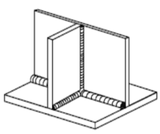

Shown welding recommendations seem to contradict Von Mises' failure theory and I don't understand it.

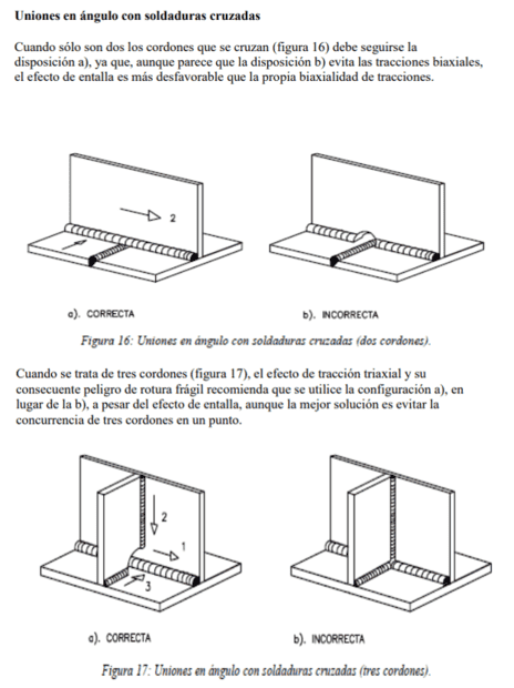

Recently I found these notes with recommendations for welded joints and something is not sitting right with me. It's in Spanish but I'll translate it as close to technical English as I can.
Original source
http://educacion.sanjuan.edu.ar/mesj/LinkClick.aspx?fileticket=dDgGbMeIr3A=&tabid=678&mid=1743
Translation to English
Angled joints with crossed cords
When only 2 cords are crossing (Figure 16) the welds must be done following a), because even if b) avoids biaxial traction, the effect from the hole (entalla) is more negative than the biaxial traction itself.
When the joint has 3 cords (Figure 17), the effect from the from the triaxial traction and its consequent danger of fragile fracture implies that the recommended configuration is a) instead of b) although the best possible solution would be to avoid having 3 cords intersecting in a point.
I have checked a few sources on the internet and they all say basically the same thing. I couldn't find English sources. Maybe I'm missing the keywords in English. I know these recommendations are used, at least in Spain, because my home university has that kind of joint at the base of the beam pillars. It's a shame I don't have a picture because I've been wondering about this since I was studying there.I'm trying to understand what's the base for these recommendations. I believe the recommendations are related to the thermal expansion of the cords and the residual stress once it cools down. I'm especially troubled with this part of the text "The triaxial traction and its consequent danger of fragile fracture".
Why is it that triaxial traction causes fragile behavior? I could not find other sources confirming this and explaining the reasons for it.
According to Von Mises's failure theory, triaxial traction is easier to withstand than uniaxial traction since its deviatoric stress should be lower even if its hydrostatic component is greater because the last ones do not contribute to failure so I don't understand why the emphasis on this triaxial tension state.

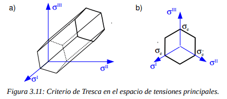

In the quadrant where all tensions are traction, it's not valid to think the plastification surface can be extended indefinitely. As it was previously pointed out, a fragile fracture will happen.
So the plastification surface predicted by the theory (what's shown is for Tresca, Von Misses would be a cylinder) must be capped somehow to agree with experimental results. I don't know if that cap can be derived mathematically or if it's obtained experimentally. The document shows the shape later.

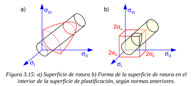

To finish, let's revisit the possiblity of a fragile fractule of a normally ductile material when working in a triaxial traction state. Let's define a fracture surface as the geometrical place where the main tensions ##\sigma_I##, ##\sigma_{II}## and ##\sigma_{III}## would cause the fracture of the material. If the fracture surface were reprensented overlapped with the plastification surface the result would be similar to what's shown in Figure 3.15a in which can be seen how fracture can happen inside the plastification surface. It is then possible to load the element is such way that it breaks before crossing the plastification surface. In other words, a fragile fracture.
The current version of the Techical Code for Edification (CTE: Código Ténico de la Edificación) does not mention this phenomemon. Perhaps because how unlikely it is to find building structures where triaxial traction occurs. However, such states can happen for example in welded joints due to residual stress depending on their geometrical disposition (as shown in this thread in the original post). Previous versions of the technical codes (EA95) indicated that even if Von Misses is satisfied it's also necessary to check ##\sigma_I<2\sigma_e##.
I believe the red surface on the left picture is from experimental results. Then, on the right side, there's the engineering simplification to cap the predictions done by the Von Misses failure theory.
In conclusion, welding cords are just a scenario that makes triaxial traction more likely depending on how they are positioned. But it's not the reason behind the fragile fracture because such a phenomenon has been observed in cases where there are no welding cords involved.
