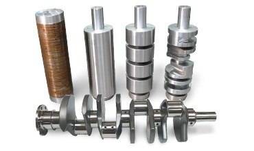

Lets look at the traditional methods to manufacture crank shafts
Starting with cast cranks, there are three options in increasing order of strength:
Cast iron, , Nodular cast iron, Cast steel
Cast iron is not pure iron at all. Pure iron is too soft to carry the load so we have to add graphite for strength.
In regular cast iron, the graphite particles are flakes. In nodular cast iron, they are spherical nodules. These nodules gives the cast iron more strength and flexibility.
Cast steel is stronger than “ Iron” simple because steel is much stronger than iron. As with iron...different alloys of steel will give a crank different levels of strength. To make a cast crankshaft, we heat iron or steel to its melting point then pour it into a mold. The up side is that this process really cuts down machining costs compared to the machine cost of a billet crank shaft.
Forged steel cranks begin with a metal bar that is heated until it is soft enough to pounded into the rough shape of the crankshaft. Then it is machined into the final shape.
The billet steel crankshaft starts with a large bar of steel is forged into a cylinder shape as large as the finished crank shaft.
I could go into which is strongest and why ..but that is another post. Let's just says the forged billet is the top of the line and the cast iron crank is the weakest.When we talk about multi piece crank shafts, I guess they would be ok but introducing the welding process can introduce a lot of unwanted stress points, really messes up grain structures, undetected stress cracks, hidden grind burns. A lot of hot rodders made their own Stroker crankshafts back in the day but the horsepower was way under 500 hp back then.
Yes you can weld up a crank shaft and it will probably work if you don’t go too big on the torque and horsepower.
