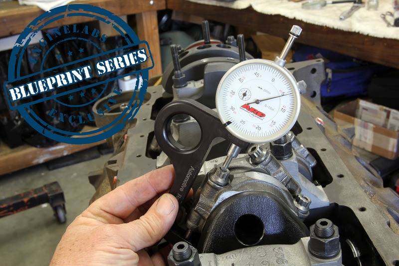

The true goal of tightening a bolt is to stretch it by a certain amount to create a tension preload. The actual torque to create that preload is actually irrelevant. When high precision is required (racing for example), the bolt is measured directly like so with a stretch gauge:
Dial indicator with a magnetic or clamp arm mounted on an engine block, its needle reading near 0 on a 0-1 inch scale, with a black connecting rod-style tool held by hand against the crankshaft area.
The torque - because of different factors, not just friction - can still be just an approximation:
https://www.enginelabs.com/engine-tech/blueprint-series-measuring-rod-bolt-stretch-vs-torque-with-arp/ said:
To hammer this lesson home, we lost a 355ci small-block Chevy on the dyno when a rod bolt failed because it had not been properly stretched. The under-torqued rod bolt nut eventually backed off after several hours of dyno testing, completely destroying the engine in the process. The cause was traced to a torque wrench that fell short by 10 lb-ft combined with new rod bolts and using engine oil as a lubricant. The resulting tolerance stack caused the failure. When we disassembled the engine, the rod bolt nut was laying in the bottom of the oil pan. All of the remaining rod bolts were badly under-stretched as well. Lesson learned.
