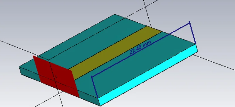

Hello, I have tried to implement an open circuit microstrip resonator .
I got the microstrip resonating at 5Ghz as shown below.

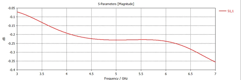

However the S-parameters is very bad.

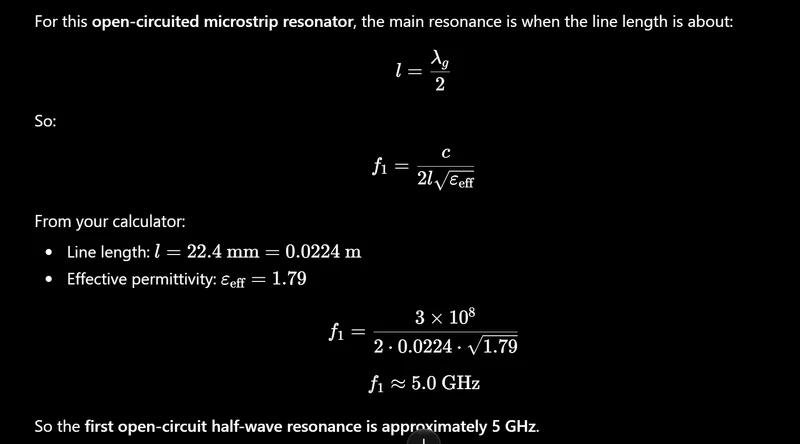

Text explanation of an open-circuit half-wave microstrip resonator: the line length l = 22.4 mm = 0.0224 m, effective permittivity 1.79, and f1 = 3 x 10^8 / (2 x 0.0224 x sqrt(1.79)) approximately 5.0 GHz.

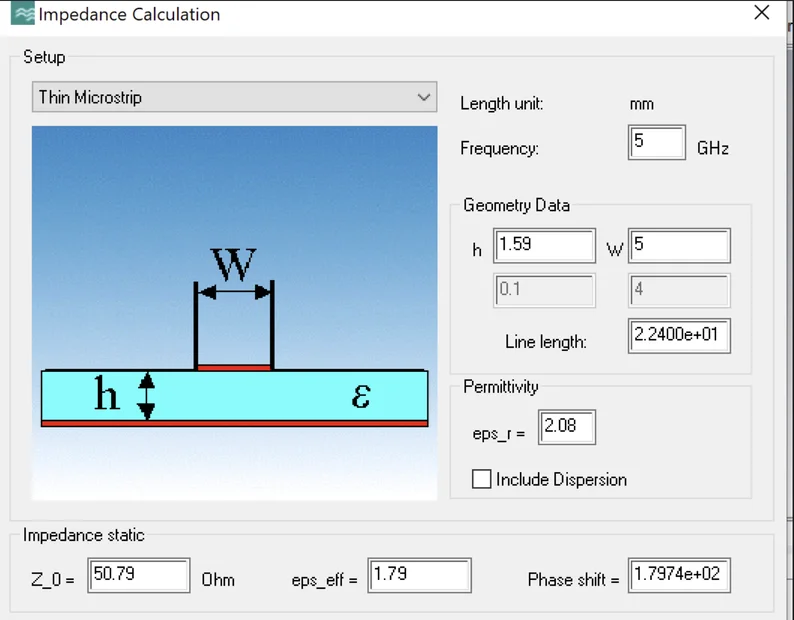

Screenshot of an Impedance Calculation dialog for a thin microstrip line, with a cross-section diagram labelled W and h and a permittivity symbol, and input fields showing frequency 5 GHz, h 1.59 mm, W 5 mm, eps_r 2.08, and results Z_0 50.79 Ohm and eps_eff 1.79.
3D simulation model of a microstrip line on a teal substrate, with a yellow-olive strip conductor, red port faces at the left end, and a blue dimension line labelled 22.40 mm along the strip length.
Line graph of S-parameters magnitude S1,1 in dB against frequency from 3 to 7 GHz, falling from about -0.07 dB to -0.35 dB with a flat region near -0.23 dB between 5 and 5.5 GHz.

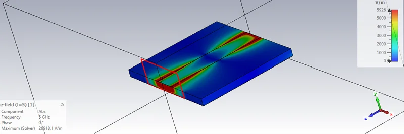

Simulation screenshot of an open-circuit microstrip resonator on a substrate, showing the E-field magnitude at 5 GHz with a colour scale in V/m from 0 to 5926, strongest near the open end of the strip.

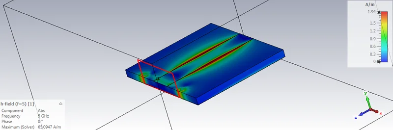

Simulation screenshot of the H-field magnitude on a microstrip resonator at 5 GHz, shown as a colour map from 0 to 1.94 A/m with red strongest and blue weakest.

If you measure S11 at one end of the resonator you will be loading it with 50Ω. That will kill any resonance.
You need to excite the resonator with a lightly coupled input signal, then view the output from a lightly coupled load. That requires three spaced strips on the PCB, one input, one resonator, and one output probe. The resonance will appear as a dip of the input, and a peak in the load on the output.
The input and output will be λ/4 long, which makes them quarter wave transformers.
The resonator will be λ/2, and so is usually bent into a 'U'.

Re S parameters: The way the (Complex) S parameters are measured is by measuring the forward and reflected waves in a 'good' 50Ohm matched system. If you want to design a circuit with a resonator in it with an S Parameter tester then I think you should be looking at the S Parameters of the whole circuit or a part of the planned circuit. The point of the resonator will be frequency selective (obvs). The S parameter could reveal the presence of a resonator by an amplitude blip or a rapid phase change with frequency, depending.
