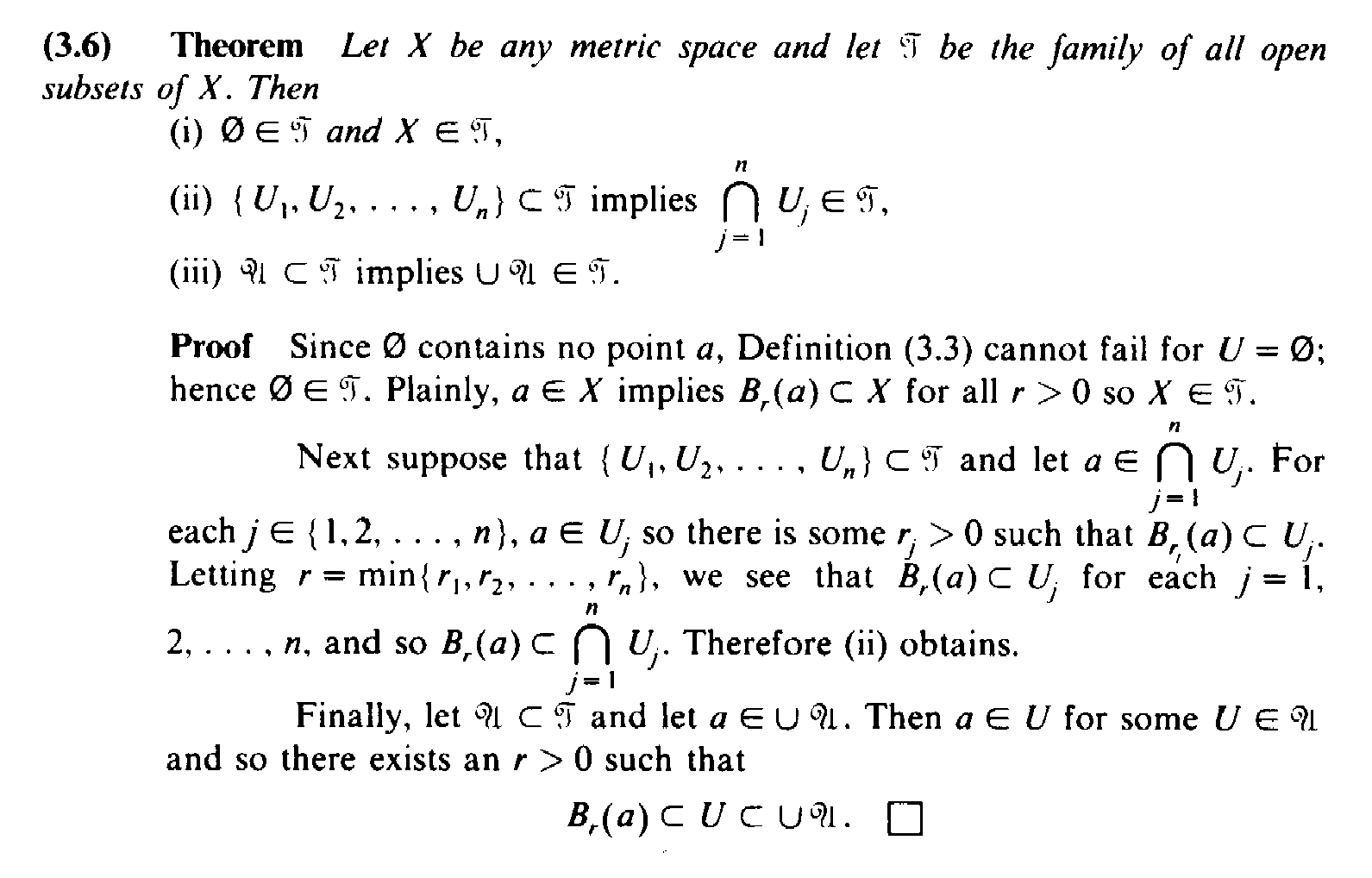

I am reading Karl R. Stromberg's book: "An Introduction to Classical Real Analysis". ... ...
I am focused on Chapter 3: Limits and Continuity ... ...
I need help in order to fully understand the proof of Theorem 3.6 on page 94 ... ... Theorem 3.6 and its proof read as follows:
In the above proof by Stromberg we read the following:
" ... ... Letting $$r = \text{min} \{ r_1, r_2, \ ... \ ... \ r_n \}$$ we see that $$B_r (a) \subset U_j \text{ for each } j = 1,2, \ ... \ ... n$$ ... ... "Although it seems plausible ... I do not see ... rigorously speaking, why the above statement is true ...
Can someone demonstrate rigorously that letting $$r = \text{min} \{ r_1, r_2, \ ... \ ... \ r_n \}$$ ...
... implies that $$B_r (a) \subset U_j$$ for each $$j = 1,2, \ ... \ ... n$$ ... ... Surely it is possible that $$B_r (a)$$ lies partly outside some $$U_j$$ ... ...
Help will be appreciated ...
Peter

The Theorem makes reference to "Definition 3.3" but you don't give us that definition. Also you are asking about "[tex]B_r(a)[/tex]" but don't tell us what that means. Since the theorem is about "open sets", I strongly suspect, but can't be sure, that "Definition 3.3" is the definition of "open set" and that "[tex]B_r(a)[/tex]" is the "open ball" centered at a with radius r.
If that is correct then [tex]B_r(a)[/tex] is [tex]\{ p| d(p, a)< r\}[/tex], the set of all points whose distance from point a (the center of the ball) is less than r (the radius of the ball). From that it follows immediately that if [tex]r_1< r_2[/tex] then [tex]B_{r_1}(a)\subset B_{r_2}(a)[/tex]- the smaller radius ball is inside the larger radius ball.

$r$ is the minimum of all the $r_j$ and so $r\leqslant r_j$ for all $j$; hence $B_r(a)\subseteq B_{r_j}(a)\subset U_j$ for all $j=1,\ldots,n$.
