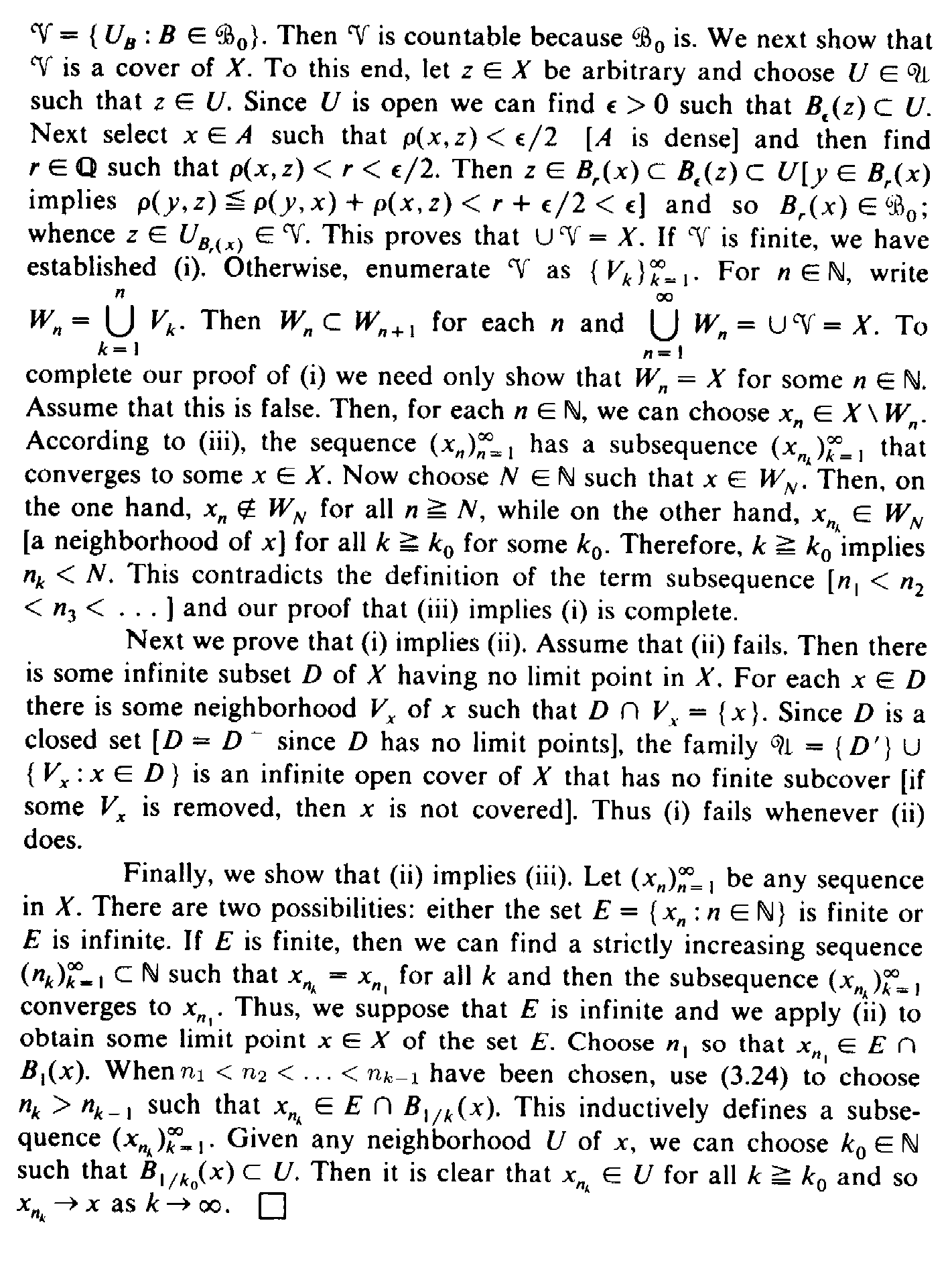

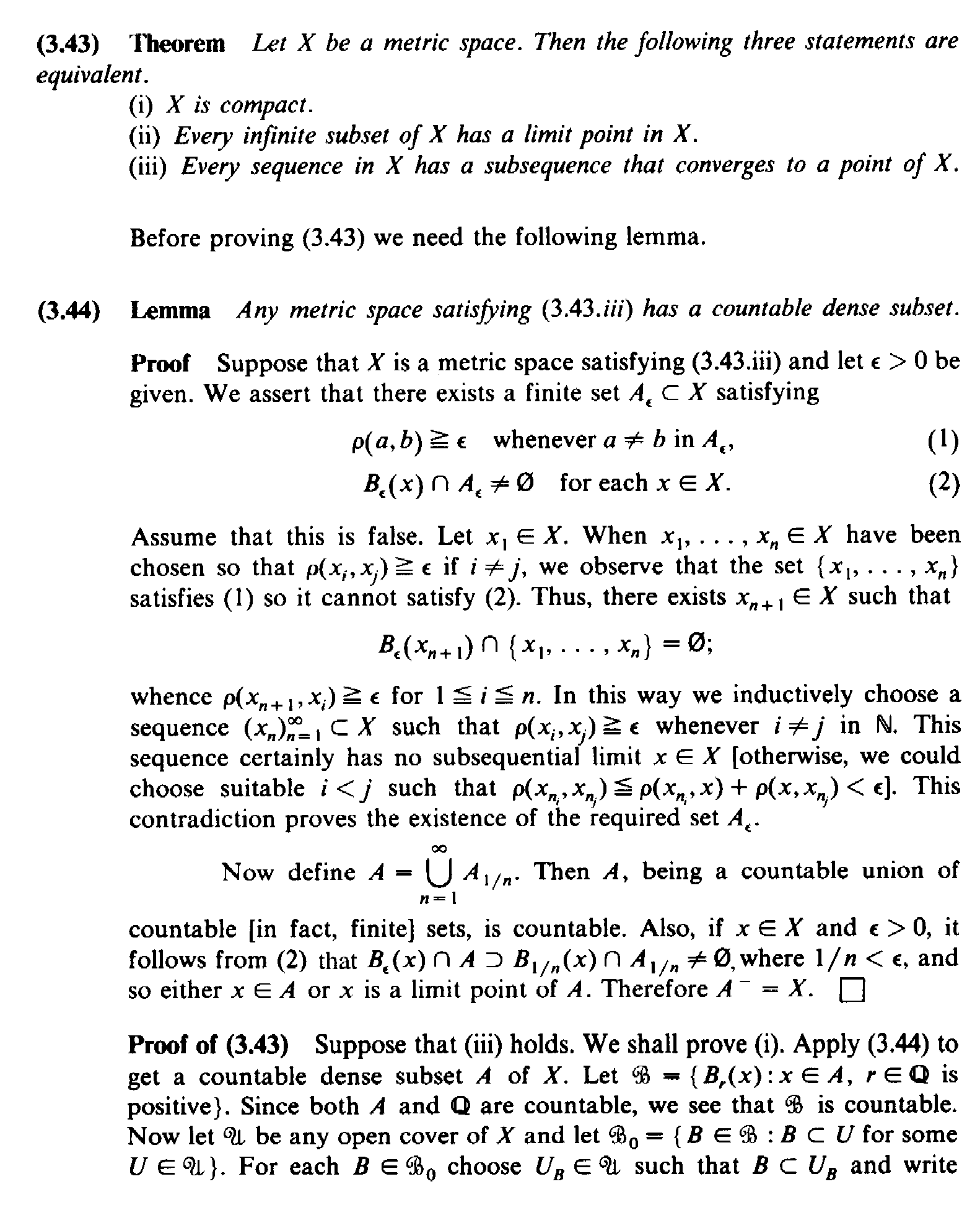

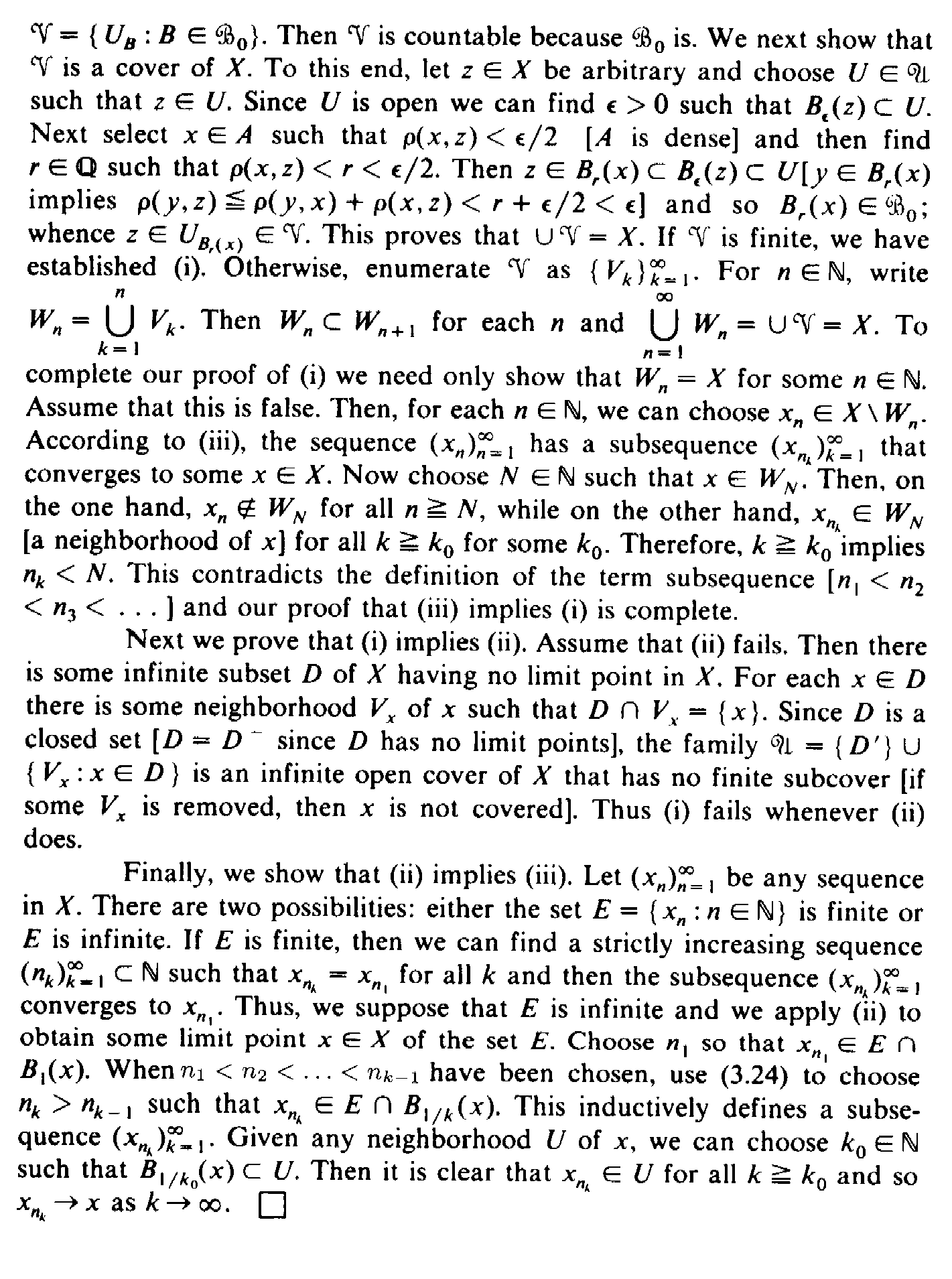

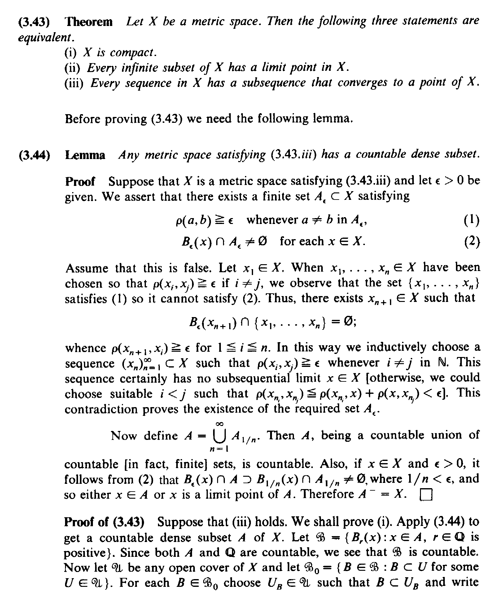

I need help in order to fully understand the proof of Theorem 3.43 on pages 105-106 ... ... Theorem 3.43 and its proof read as follows:View attachment 9144
At about the middle of the above proof by Stromberg we read the following:
" ... ...Next select $$x \in A$$ such that $$\rho (x, z) \lt \epsilon / 2$$ [$$A$$ is dense] ... ... "My question is as follows:
Can someone demonstrate rigorously how $$A$$ is dense in $$X$$ guarantees that we can select $$x \in A$$ such that $$\rho (x, z) \lt \epsilon / 2$$ ... ...

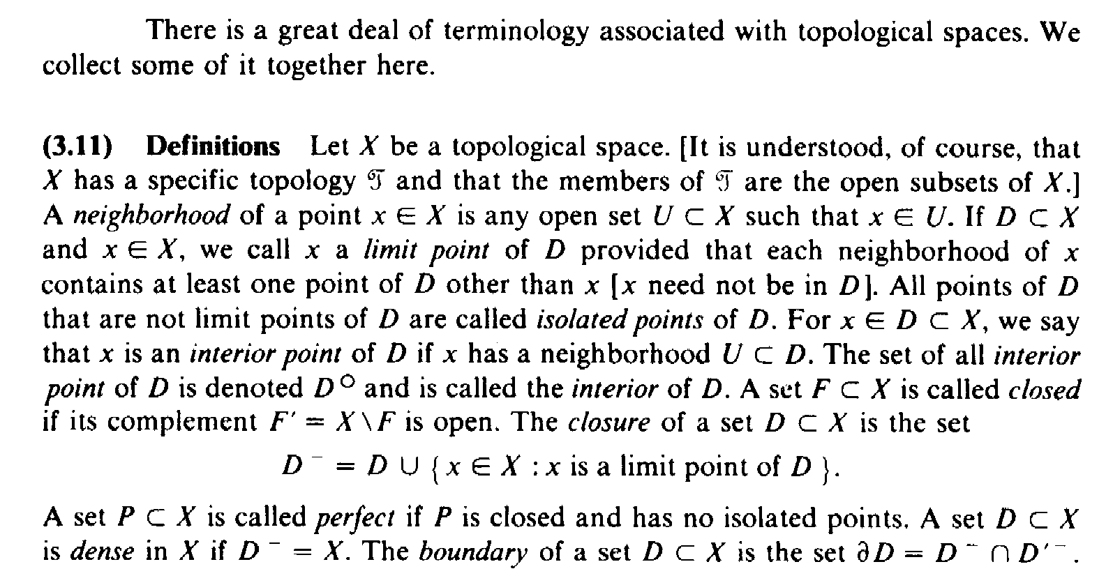

Stromberg defines dense in X as follows ... ...
A set $$A \subset X$$ is dense in $$X$$ if $$A^{ - } = X$$.

You have "A set A is dense in X if $D^-= X$. Doesn't Stromberg define "$D^-$ for a set A? Is it defined as the closure of A? I would think that would be $A^-$ rather than "D"! Where did the "D" come from?
(Actually the definition given later in what you copied is for "set D", not "set A".)
