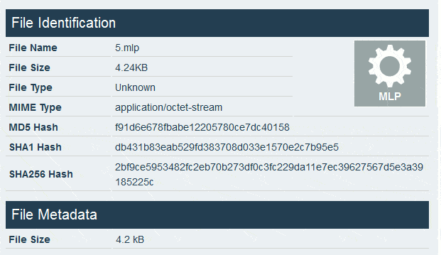

http://www.fileformat.info/tool/hexdump.htm
File identification table for 5.mlp: size 4.24KB, type Unknown, MIME application/octet-stream, with MD5, SHA1 and SHA256 hash values, followed by a File Metadata section showing size 4.2 kB.
This dump is only partially helpful. The first few bytes are an identifying header and seeing the dots means you really need to look at the hex values for those bytes as they may be filler, or binary data like a floating or number...
