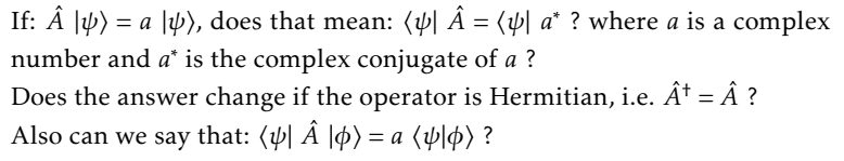

Please see the attached equations and help, I Think I am confused about this​
Three questions in Dirac notation: if A|psi> = a|psi>, does <psi|A = <psi|a*; does the answer change for Hermitian A; and is <psi|A|phi> = a<psi|phi>?
We should treat this as a homework problem. Can you make an attempt at answering it?

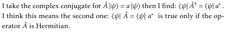

Looks good. Can you say anything more if ##\hat A## is Hermitian?
If A is Hermitian then the eigenvalue (a) is a real number.

I don't think it is true in general for any operator. Certainly for Hermitian operators and also for normal operators (these are operators that commute with their Hermitian conjugate), but not in general.
Switching to normal linear algebra notation. If ##A## commutes with ##A^{\dagger}## and ##v## is an eigenvector of ##A## with eigenvalue ##a##, then:
$$A(A^{\dagger}v) = A^{\dagger}(Av) = A^{\dagger}(av) = a(A^{\dagger}v)$$ and we see that ##A^{\dagger}v## is an eigenvector of ##A## with eigenvalue ##a##. Which means that ##A## and ##A^{\dagger}## share eigenspaces.
And it's easy to show that the eigenvalues are complex conjugates.
You can use that to prove the identity in your question, but I think you need that condition.

Can we say that if the operator is Hermitian then: <ψ| A |Φ> =<Φ| A |ψ>*= a <Φ | ψ>* = a <ψ | Φ> ?
Yes, and if we assume that ##A## and ##A^{\dagger}## share eigenvectors with cc eigenvalues, then: $$\langle \psi |A| \phi \rangle = \langle \phi |A^{\dagger}| \psi \rangle^* = \langle \phi |a^*| \psi \rangle^* = a\langle \psi |\phi \rangle$$ So, that's slightly more general than Hermitian, with ##A## normal and non-degenerate.

It is clear now. It seems to me that I need to educate myself and study more in linear algebra. Thank you for your help!
PS ultimately it's simply this equality you need: $$A^{\dagger}| \psi \rangle = a^*| \psi \rangle$$ And that holds for Hermitian operators, some other operators, but not all operators.
