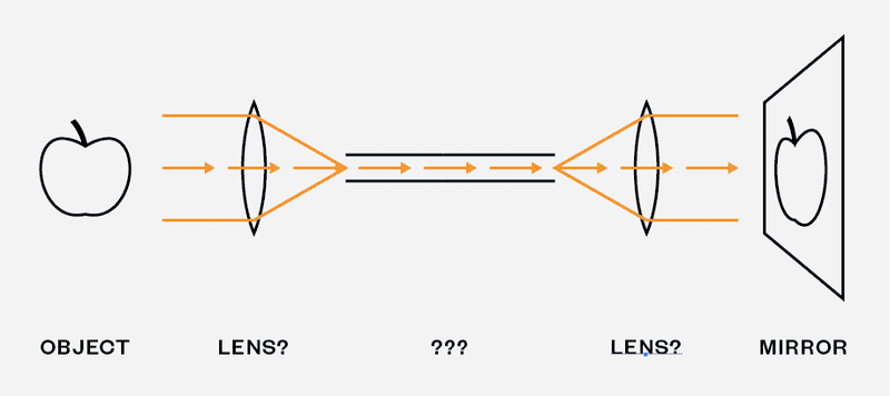

I'm working on an art project and I wonder if there's any mean by which I can transport the light from an illuminated scene across a small tube (let say not larger than 5 cm in diameter) and over some distance (let say 2 meters) and restitute that light on a large mirror.
Please see my image below.
Thank you!

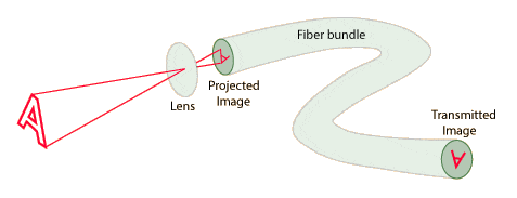

Are you familiar with fiber optic bundles? I'm not sure you will get a very bright final image, however...
http://hyperphysics.phy-astr.gsu.edu/hbase/optmod/fibopt.html
http://hyperphysics.phy-astr.gsu.edu/hbase/optmod/imgopm/fibop2.gif
Thank you. I've read about those, I think the final image would be pixelated. I need the final image to be perfect, as if a direct reflexion on a mirror.
I've just read about rod lenses, I think it's my best bet for the moment. Are you familiar with those?
My other question would be, how to "expand" the final image on a large surface (on a mirror, to preserve 3D ?).
How far do you want to transmit this image? I.e. how long is the rod?
If the distance is short I would probably get two cheap, low powered telescopes and put them eyepiece to eyepiece. The beam in between the eyepieces should be collimated and therefore perform the same job as your rod.
Unless your system is perfect and the resultant image is the same size as the original you will loose brightness.
However, far simpler would be a digital camera one end and a projector the other.

I am right to think that collimated light wouldn't preserve parallax? I.e. when I look in a mirror, the reflection appears in 3D. If light is collimated before reaching the final mirror, would it still appears in 3D?
Can you use a webcam and mini projector?

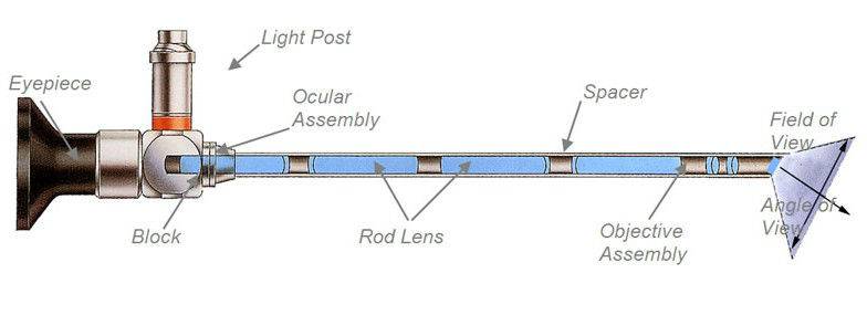

The only real way to do as you envision is to fill the tube with a bunch of relay lenses, and since you are not a lens designer this will result in a horribly aberrated final image.
Thanks for your input Andy. So rod lenses couldn't work? I could buy a borescope and use the middle section.
Sure, a borescope/endoscope/etc could work, but modern ones simply put a small camera at the end. Old-timey ones, AFAIK, don't extend much beyond a foot or so.
