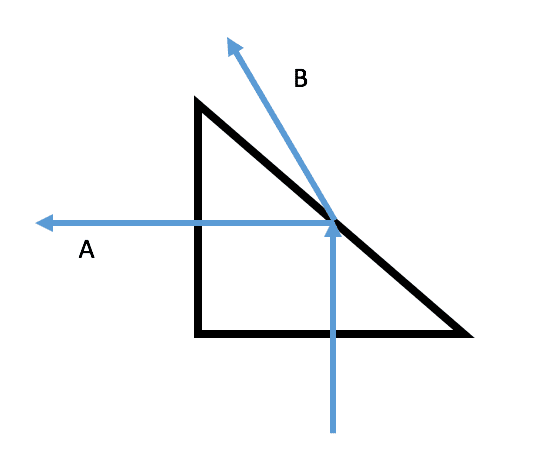

The two rays shown below, a and b, have different wavelengths. They travel through the glass prism as shown; 1) is this possible? 2) If this is possible, which has the longer wavelength, ray a or ray b?
[see attached figure]
λ = λi/n
critical angle = arcsin(n2/n1)
We are trying to think through this but we keep hitting mental blocks. We know that a and b have different wavelengths, and that both of the wavelengths will change by the same factor when they enter the glass. We also know that you will get total internal reflection (TIR) at some angle specified by the indices of refraction for the glass prism and air.
We aren't totally convinced that this is possible, because the critical angle depends wholly on the indices of refraction, which are independent of wavelength. Is this correct reasoning? By this logic, it is not possible.

If we use the refractive indices for red light and purple light, for example, we get 1.54 for red light and 1.59 for purple light (given in our textbook). In the diagram we see that one ray (ray A) is internally reflecting, while ray B is still refracting. By the diagram, it appears that the two rays are hitting the side of the prism at 45 degrees. If this is true, then both ray A and ray B should be internally reflecting because 45 degrees is greater than the critical angle (40.49 for 1.54 and 38.97 for 1.59). Are there two wavelengths that would make the difference in n great enough that ray A would internally reflect and ray B would refract?
Not according to the image you posted.

As I wrote, in the diagram you posted, it looks significantly less than 45 degrees. I measured the triangle sides and calculated the incidence angle as 40.9 degrees.

I (we) believe the diagram intends to show two rays of different wavelength entering on the same path, one undergoing total internal reflection, the other emerging, refracted, from the hypotenuse. The OP is trying to understand whether this can be true for visible light in glass, and has determined it requires the incidence angle to be around 40 degrees. I maintain it is about that in the diagram.

I thought it should have been one ray entering and two leaving. But even if there were two rays, how can we draw any conclusions about the wavelengths, for there is only one refraction. Or do we assume there are actually two refractions at the splitting point? One by 45° looking like a reflection?

It says A and B, shown leaving, have different wavelengths. Unless the prism is magically changing the frequencies, that means two at different wavelengths entered.
The refractive index depends on the wavelength. If the two rays are both visible light then that limits the range of indices. The question is whether the diagram can be reasonably interpreted as showing an angle of incidence that would allow one wavelength of visible light to be internally reflected but not the other.

Strictly speaking, yes. At incidence less than the critical angle, there is some reflection as well as refraction. But the question clearly says the two emergent rays are at different wavelengths. There should be a third ray, the partial reflection of ray B, but the omission of that is not important.

I just realized what is wrong with the diagram, and this may be causing your problem. The reflection shown is at the wrong angle. It should be the same as the incident angle, so should slope down to the left, not be horizontal.

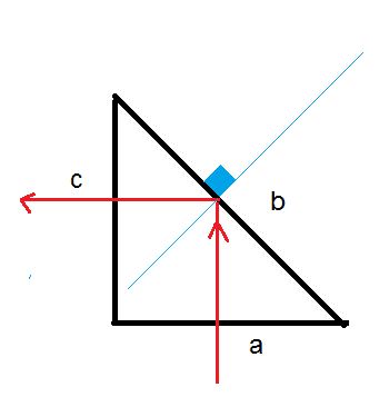

See figure. If it is an equilateral right triangle, and the light hits the side a perpendicularly, it is incident on side b at 45°, reflected at 45°and incident perpendicularly at side c. At normal incidence, the transmitted light does not change direction.

I disagree. The slope of the hypotenuse is clearly not 45 degrees. Indeed, it is about 40 degrees, as it needs to be to make it feasible that two visible rays will behave differently. I think it more likely that the reflected ray was drawn carelessly. The reflection angle is clearly larger than the incidence angle.
