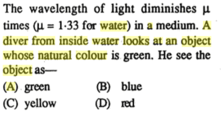

Since wavelength of light reduces on entering
water , then the wavelength of light entering the eyes of diver is less than the wavelength of green light .
Out of the given options , option B) i.e blue color is the only one with wavelength less than green .
But this is not the correct option .
What is the mistake ?

So I'm guessing you got this question wrong and you are trying to argue with the teacher using the wavelength notion.
The problem here is that the light ray has traversed through two mediums to get to your eyes and while its true the wavelength has shortened in the water medium, its also true that its speed has diminished as well.
Now the tricky part here is to realize that the conservation of energy is at work so that photons traveling in air and then in water will retain the same energy and hence the same frequency across the transition. Photons of the same energy excite the photoreceptors in the same way hence giving you the sense of seeing the same color. This means that you can't use wavelength as a means to describe what the eye sees but rather the energy or the frequency of the photon as to what the eye sees.
I like to use the energy of the photon because it relates to the excitation of some electron in the photoreceptor protein that triggers the sense of the color we are seeing. Its more of the quantum mechanical view of the process.

One last point I forgot to mention is why green was chosen for the problem. The question author no doubt chose green because green and blue photons can penetrate the water column the deepest whereas other colors are attenuated ie disappear as you go deeper.
This means that a multicolored object would lose some of its color depending on depth. One such example would be viewing the American flag (red/white/blue color pattern) from underwater as you got deeper the red would disappear and appear as black. The white which reflects all light would become blue meaning the flag would look like shades of black and blue stripes and stars and finally it would all just be blackness when no more light can penetrate the depth.
https://oceanservice.noaa.gov/facts/light_travel.html
The other part of the question "diminished wavelength" while true was designed to mislead the student who most probably is thinking of color in terms of wavelength.
In truth, I got fooled by this too and after talking it over with a colleague understood the nature of the question and my confusion.
Thanks for bringing this question to PF, I think we all learned something here.

Jahnavi said:
Don't you think it is easy to get the wrong notion considering the fact that colours are related to wavelengths , and wavelengths change as the medium changes ?
Yes, it's easy to misunderstand since it color is usually given in terms of a wavelength instead of a frequency or an energy. The latter two never change.
