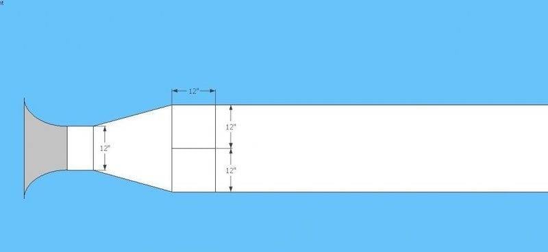

I have 2 exhaust fans that can handle 1000 cfm each. Diameter of each fan is 12 inches. I need to fit these 2 inside a duct in parallel. Hence the duct cross section will be 12x24. But the suction side of the duct can only be 12x12. Hence we see that the duct from the inlet to where the 2 blowers sit, is a diverging shape. If I fit a bell mouth at the inlet that is 12x12, the shape looks like a venturi.
Q1. In this given condition, what is the ideal cfm that i can expect ?
Q2. What if there were 4 or 6 fans in parallel ?
Regards
Dilip
Please provide a drawing of the entire system. I can't picture it from your description and can't tell if you've made changes or just added elements to it.
Dear sir,
please have a look at the rough drawing and advice
I have run an air flow analysis program using a round orifice with an equivalent area to your 12" x 12" square restriction and an orifice factor of 1 (100% efficient) that shows that there will be a best case 1 psia pressure drop across that restricted entry at a 20,000 scfm flow rate. Unfortunately, I don't know how that result may be applied to determine its effect on the fans' performance.

Is this still connected to the system described in the first post? Do you have a fan curve for the fans? At what static pressure can they produce 1000 CFM?
