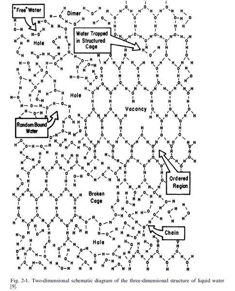

The reason I ask is I found this diagram in a textbook and find it very curious -
Is this a realistic representation of water?
The textbook is "Solvents and Solvent Effects in Organic Chemistry" by Christian Reichardt
The cited reference [9] is [9] R. A. Horne: The Structure of Water and Aqueous Solutions, in A. F. Scott (ed.): Survey of Progress in Chemistry 4, 1 (1968).
But I couldn't find a copy of this reference.
Thanks for your help/opinion
Define "realistic" :smile:
In some ways it is realistic, in some ways it is not.
I would guess this is not room temp. water. This looks like what I imagine freezing/thawing water to look like.
Definitely it must be a matter of temperature.
