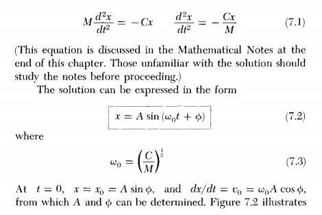

In the equation 7.4, the author is taking v0=√(C/M)*x, and I don't get where does that come from. I would really appreciatte your help, thanks.

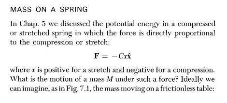

It doesn't say much, cause it's trying to explain spring oscillators in a general way.

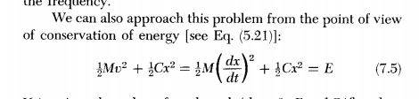

Equation (7.5) in the text is
$$\frac{1}{2} Mv^2 + \frac{1}{2} Cx^2 = \frac{1}{2} M \left( \frac{dx}{dt} \right)^2 + \frac{1}{2} Cx^2 = E,$$
where ##E## is the constant ##\frac{1}{2} CA^2##. Here, ##C## is the spring constant and ##A## is the amplitude of oscillation..
This means that
$$\frac{1}{2} Mv^2 + \frac{1}{2} Cx^2 = \frac{1}{2} CA^2$$
at all times ##t##. Setting ##t=0## gives
$$\frac{1}{2} Mv_0^2 + \frac{1}{2} Cx_0^2 = \frac{1}{2} CA^2,$$
so that
$$v_0^2 = \frac{C}{M} \left( A^2 - x_0^2 \right) = \omega_0^2 \left( A^2 - x_0^2 \right).$$
Also, I do not understand
velvetmist said:
But we got that ## x = A \sin(\phi)##
Actually, ##x = A \sin \left( \omega_0 t + \phi \right)##.

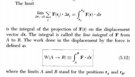

(5.12) integral. And yes, i just realized that I cropted it in a wrong way, but basically: $$\Delta T = \frac 1 2 Mv^2-\frac 1 2 Mv_0^2.$$

That's because
$$ \Delta (T+V) =\Delta E = \frac 1 2 Mv^2-\frac 1 2 Mv_0^2,$$
cause here ##\Delta V=0.## And we also know that
then
$$\frac 1 2 Mv^2-\frac 1 2 Mv_0^2 = \frac{1}{2} M \left( \frac{dx}{dt} \right)^2 + \frac{1}{2} Cx^2.$$

Sorry, i just didn't read "at t=0", which is a huge mistake, but even like that i think is kind of weird cause he have that
$$ v_0 = \sqrt {\frac {C} M} A \cos(\phi) = \sqrt {\frac {-C} M}x .$$
And we know that
$$x = A \sin \left( \omega_0 t + \phi \right).$$
Then
$$v_0 = \sqrt {\frac {C} M} A \cos(\phi) = \sqrt {\frac {-C} M} A \sin \left( \omega_0 t + \phi \right).$$
$$\sqrt {-1}\cos(\phi)=\sin \left( \omega_0 t + \phi \right).$$
I probably made a mistake, or something like that cause i find this equation really weird.
