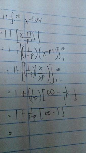

why it will equals to p / p-1 ?
Do the integral and see what you get.
i got this

Mr Vickson answers your question "why the harmonic serie diverges?" by comparing the harmonic serie to an integral. The conclusion of it is that the partial sum ##H_N = \sum_{n=1}^N \frac{1}{n}## is equivalent as ##N \to +\infty## to ##\ln N##. This means that as ##N\to \infty##, ##H_N / \ln N \to 1 ##, showing that ##H_N## can't have a finite limit.
