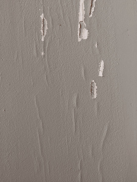

As you can see from the image a vertical portion of my wall (a wood beam) has developed this vertical bubbling where the paint is being rejected. It spans from the ceiling to floor. First thing I thought of was water damage, but as I chip away at the paint and get to the wood it doesn't seem like there is obvious damage, but maybe it's further in the wood? Any other reasons this is happening? Do I simply keep chipping away, then slab a bit of spackle on the plaster and repaint?

How young is the beam? Fresh or treated wood could gas out.
Almost 100 years old :)
Strange. It's too late here now to consult my expert. As the bubbles are along the texture (I assume), there must be a relation. Reminds me a bit on a math joke about a correct but by no means helpful answer. Could it be, that moisture from the paint got into the cracks and dried out later than the rest, namely the surface. Now if the paint is old as well, but the bubbles are not, then it's a real puzzle.
I bought the place two years ago as a foreclosure. I know the coat of paint on there now was done fairly recent from when I bought it. I don't remember seeing the bubbling when I bought it. I'm sure I'd remember it and be concerned.
Is it a large area? If not, can you sand it down, make sure it's dry, use a good primer, then re-paint?
What is on the other side of the wood?

Wood expands and contracts as it absorbs humidity. This can occur seasonally.
More of this kind of size change goes across the grain, relatively little will go the length of the grain or the wood.
I am not sure that I would call your first picture bubble rather than folding up of paint with the underlying wood has shrunk.
Bubbling I have seem has more of a rounded top (due to pressure inside the bubble) while your picture seems to show a series of peaks.
Size changes of wood framing might also explain the cracks at drywall seams if the panels are moving independently.

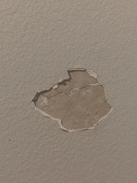

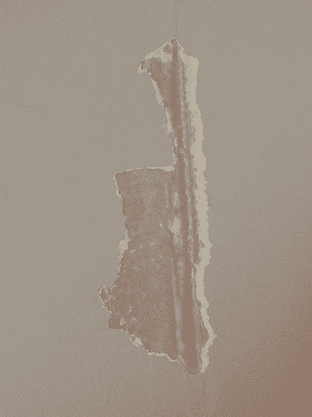

What's the material under the surface in these two images? I'm not any expert on plaster, but it seems unusual to have plaster applied directly to a wood beam. The usual substrate for plaster is wood strips (laths) and/or a kind of chickenwire mesh. I'm wondering if the wood beam in the picture in post #1 is picking up moisture from outside, causing it to expand and generate cracks on the inside surface, along the lines of what @fresh_42 said about wood "working." I don't think the moisture would necessarily be in the form of liquid water - vapor could pass though without the wood seeming to be very wet.
The first photo is a wood support beam. The next two are plaster.

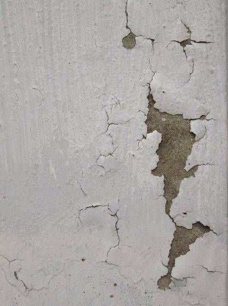

It looks to me like you have a keying (bonding) problem between the base and finish coat. If the base coat is still solid then your best option is probably a liquid key. If possible avoid using gypsum with lime and vice versa. At 100 years your wall is on the cusp and could go either way. Also don't use drywall joint compound. Besides, plaster doesn't stick to a trowel like joint compound and is much easier to use.
http://www.awci.org/cd/pdfs/9310_a.pdf
I'm not sure what happened with the edit but my suggestion refers to what appears to be the plaster delamination and not the paint issue.
For the paint, is it possible the base is too "lime" hot for the paint? If so it will need to be sealed for any acrylic to work. Do a ph test on the wall and paints have a MSDS sheet which should identify their usable ph range.
From your photo, it looks like you've been able to gouge bits of wood away from beneath the bubbled paint? Is that right?
If so, can you follow a line of too-soft wood inwards, e.g., by scraping with a chisel or other sharp instrument? Do you eventually reach a point where the wood feels hard again?
If not, does that mean the wood felt hard everywhere and the paint was just lifting off the top?
It's really important to do a reliable differential diagnosis to pin this down, since the "solutions" in each case are very different.
If your paint isn't adhering to plaster, try wiping it down with muriatic acid, then letting it dry completely. then prime and paint.
Also, is your ceiling plaster and lath?? When the cleaning lady came into the church next door to where I grew up, she found the ceiling had fallen in completely between Sunday night and Wednesday am. the building inspector came in and investigated, he found that the nails used to hold the lath to the ceiling joist had rusted thru and completely failed. This was a one hundred plus year old building, that is why I bring it up.

This is the case, the paint, which is many layers deep after 100 years, is lifting off the wood which appears to me to be in very good condition.
Hmm. Wood dynamically expands and contracts as a function of relative humidity. Higher RH = higher moisture content, MC. Most wood is planesawn, so tangential expansion/contraction, which has the largest coeffiecient of expansion, dominates. Those cracks parallel the grain and are the result of wood movement - tangentially.
FWIW - As a blanket statement, it is not correct to say that using latex coatings over oil-based coatings is always poor practice. The Forest Products Laboratory of the USDA has a series of publications based on extensive experiments.
What Greg has is most likely related to moisture differential between exterior and interior. In the US modern construction uses a moisture barrier (Example Tyvek) to limit this problem. Older construction in the US does not have a moisture barrier. So the source of the problem has more to do with the quality of exterior sheathing, or lack thereof. i.e., moisture migration, if I understood correctly.
Anyway, some of the comments in the thread do not match up with what the FPL research shows. If you have the time, browse and read some articles meant to help coating producers and the people who use the products get great results. And yes, surface prep is important, too.

A telltale sign is that the bubbles in your pic seem to be following grain lines (or gum/resin lines?) in the wood. Is that right? (I can't quite tell from your pic.) You seem to have gouged out a few mm below the surface of the wood where you've scraped the paint.(?)
If they are resin lines,... well,... I learned years ago that they're a bad thing in the long term. For visible sections, I'd always dig out the resin and refill it with an epoxy. E.g., epoxy grout, or fiber glass resin thickened with fine sawdust or the ultrafine white "balloon" powder that some epoxy suppliers provide.
For 100 yr old wood you also have another phenomenon at work: the natural substances in the timber gradually oxidize over the decades, making it harden and shrink (which is why very old timber is far harder and more stable than new wood). But the gum/resin lines will probably shrink at a different rate from the cellulose in the main body of the timber.
Anyway,... before starting any serious repair work, I'd want to know what's happening on the other side of the beam. (IIUC, you can't access the other side?) You can probably buy an inexpensive moisture detector like https://www.jaycar.com.au/pocket-moisture-level-meter-for-wood-building-materials/p/QP2310 to find out if there's moisture deep inside the beam, without having to cut it. (That url is for an Australian shop, but I daresay you have similar outlets in your part of the world.) These devices are also used by termite inspectors to detect the presence of pests in wood (since their presence elevates the moisture level).

New update, it's not a beam, but a hallow wood encasement that encloses a radiator pipe. I still don't see any sign of water damage.
Oh, well that changes things completely. Now I'm wondering whether you'd be able to lever off part (or all) of the encasement, and replace with something non-timber, e.g., a piece of CFC (compressed fibre cement) sheet.
I remember in one of my bathrooms (from 3 homes ago), there was a panel in the wall to allow access to the sewer downpipe coming down from from higher apartments. The panel was made of particle board and, (even though painted), it had started to degrade in an unsightly way. So we replaced it with CFC sheet, and things were much better after that.
