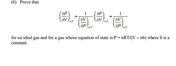

ramsharmjarm Messages 7 Reaction score 0 Thread starter Sep 14, 2012 #1 Homework Statement Please look at the attached pic. I don't know how to type all these symbols in. Homework Equations Im not sure how to start The Attempt at a Solution I tried using the cyclic rule but the problem just started getting messier. Attachments Help.jpg 8.6 KB · Views: 429

HallsofIvy Science Advisor Homework Helper Messages 42,895 Reaction score 983 Sep 15, 2012 #2 I don't know what you mean by the "cylic rule" but this is a simple application of the "chain rule". Of course, the fact that n and T are held constant is important.

ramsharmjarm Messages 7 Reaction score 0 Sep 15, 2012 #3 am i starting this right then? dp/dv = d(nRT/V)/dV= dnrT/Vdv)
