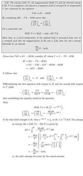

This question is about entropy of magnetic salts. I got up to the point of finding H1, the final applied field.
But instead of doing integration I used this:
dS = (∂S/∂H)*dH
= (M0/4α)(ln 4)2
I removed the negative sign because they wanted decrease in S.
I know integration is the sure-fire way to get Sinitial - Sfinal but why is this method wrong? Is it because this method is only an approximation?
dS = (∂S/∂H)*dH
= (M0/4α)(ln 4)2 I removed the negative sign because they wanted decrease in S.I know integration is the sure-fire way to get Sinitial - Sfinal but why is this method wrong? Is it because this method is only an approximation?
I'm not sure exactly what you'e done here. [itex]dH[/itex] is a differential, so it makes no sense to say that [itex]\left( \frac{ \partial S}{ \partial H } \right)_{T} dH = \frac{M_0}{4\alpha}\ln(4)^2[/itex].
If you Taylor expand [itex]S(H, T)[/itex] around the point H=0, holding T constant. then to first order you get
[tex]S(H_1, T) \approx \left. \left. \left( \frac{ \partial S}{ \partial H } \right)_{T} \right. \right|_{H=H_1} \cdot (H_1-0)= \frac{M_0}{4\alpha}\ln(4)^2[/tex]
but that is only a first order approximation.

What I meant was:
dS = (∂S/∂H)*dH + (∂S/∂T)dT
But since dT = 0 since T is kept constant,
dS = (∂S/∂H)*dH
unscientific said:
What I meant was:
dS = (∂S/∂H)*dH
That's completely correct, but how did you get from that to (M0/4α)(ln 4)2?
