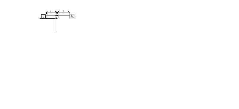

Two blocks A and B , each of same mass m are attached by a thin inextensible string through an ideal pulley .
Initially block B is held in position as shown in figure . Now the block B is released . Block A will slide to right and hit the pulley in time t(a) . Block B will swing and hit the surface in time t(b).
Assume the surface as frictionless.
Then prove that ,
t(a)<t(b)
Let the tension in the string be T .
L=1/2(T/m)[t(a)^2]
How to get the time t(b) .
hi nik jain! :smile:
the tension isn't constant, is it? :wink:
call the tension T(t),
do F = ma for block A, and F = ma and τ = Iα for block B …
what do you get? :smile:​
Yes Tension is not constant.
Let the block moves a distance (x) .
1/2m[v(a)^2] = Tx (By energy conservation)
1/2m[v(a)^2] = mAx (A is the acceleration of block A)
1/2m[v(a)^2] = mv(a)(dv/dx)x
integrating it
v(a) = (2x)^1/2
again integrating it
t(a) = (L/2)^1/2
How to get the t(b) ?
Please make the equation as above .
And how the acceleration of block A relates to the acceleration of block B ?
(try using the X2 button just above the Reply box :wink:)
But T is not constant, so it's 1/2m[v(a)^2] = ∫ T dx
But now you've lost T. :redface:
The whole point is to connect the A and B equations, using T.
For B, you will need two parameters, length and angle. :wink:​
