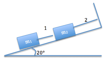

This is a problem from my physics homework. I copied the diagram below as best I could from the text. It's not the best rendering but you'll get the idea.
1. Homework Statement
Two blocks are at rest on a frictionless incline, as shown in the figure.
Diagram of two blocks on a frictionless incline at 20 degrees, labelled m1 and m2, connected by strings numbered 1 and 2 running up the slope to a pulley at the top.
Part A. What is the tension in the string number 1 if m1 = 9.0kg and m2 = 3.9kg?
Part B. What is the tension in the string number 2 if m1 = 9.0kg and m2 = 3.9kg?
The answer to Part A is: T1 = 30.2 N, which I don't understand.
So far, I know the following:
F = ma
Fx = max
Fy = may
w = wy = mg = 9.0kg * 9.8 m/s2 = 88.2 N
I tried splitting the tension of string 1 into its vector x and y components, but that wasn't getting me to the right answer. I am not quite sure where to start or how they got that answer, 30.2 N (part A). Any guidance would be much appreciated.
Ty = mg = 88.2 N
T = Ty/sin(20) = 257.9 N

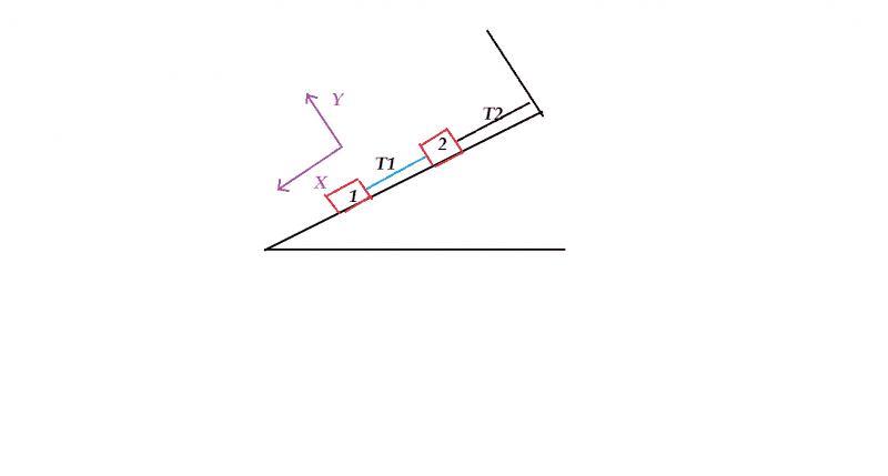

Diagram of two blocks labelled 1 and 2 on an inclined plane, connected by string T1, with a second string T2 running to a pulley or wall at the top; purple X and Y axes drawn at an angle to the slope.
Hi David welcome to PF.
I suggest you to choose your co-ordinate axis as shown in figure.
After drawing free body diagrams of m1 can you find T1?
It does work to have the axes so gravity points in the -y direction ... but, as Satvik suggests, the maths is way easier if you point the x-axis along the slope. The reason you are having trouble is probably because you have not included all the forces on each mass ...
The first step is always to draw a free body diagram - make it a habit.
Please tell us what forces you put on it and where they point.
