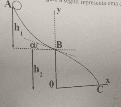

How can I find ##h_{2}## in terms of the other variables knowing that the horizontal distance between B and C is 10m? (the particle is initially at rest)
##E_{i} = E_{f}##
241905
I first found ##v_{B}## by ##E_{p,A,B} = mgh_{1} = E_{c, B} = \frac{1}{2}mv_{B}^2 \therefore v_{B} = \sqrt{2gh_{1}} ##
After this I made several failed attempts basically trying to find its final velocity so I could use conservation of energy. Spliting the velocity into its components never worked because the force in these components varies with the angle as it falls.
Are we told anything else?
For example, is that curve supposed to be a cubic curve?
In the segment from B to C, is the particle supported by the track - or is it following a parabolic path?

What are you trying to calculate? Why can't ##h_2## be any height you like?

There seem to only two constraints on the segment from B to C. The first is that the particle rests on the track, so the particle cannot fall any faster than if there was no track there. That would be a parabolic path and would give you a maximum value for h2.
The other constraint is that B appears to be an inflection point - with the path never again rising to meet the tangent line at point B. So at its highest, the B to C segment will follow just below that tangent line - giving the minimum value for h2.

yes, it's in portuguese. I don't have the file now (it's on my PC), apart from what I've written in my previous answer, it only asks to find:
•The velocity at B
•The x and y components of the velocity at B
•The height h2 knowing that the horizontal distance between B and C is 10m
The first two are elementar, maybe that's an indicator that there might be missing information

because if the problem is consistent (which I'm not sure), ##h_{2}## can be written as function of the other given variables
Unless the path from B to C is falling under gravity (no track), then there is no unique solution for the shape of the track from B to C, as @.Scott has said.
