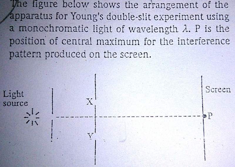

A transparent flim of thickness t and reflective index n is placed in front of Y . Which one shows the new condition for destructive intefrence to occur ? the ans is (n-1) t = m λ
. In my opinion , it should be (n-1) t = (m-0.5) λ ,
because for destructive interference to occur , the path difference should be 0.5λ

You seem to be pretty lazy (which may be a good quality) not filling in 2 and 3. Never mind. Could you be so good as to post the problem statement in facsimile too ? Is it a multiple choice thing (since it asks "Which one shows.."). And how do you know the ans ?

From what you've written, I surmise that the question may actually be along these lines...
There is a point (which I'll denote as D) where there is a dark band. The piece of film is placed in front of Y. What is the condition for destructive interference to again occur at that point D?

yes , this is roughly what the question means .

There is not much point just guessing. It's time to draw some diagrams and think about this really closely.
Attach your diagrams so we can see how you go about it.

SORRY , all。 please ignore my few post before it. my ans is still (n-1) t = (m-0.5) λ , but the ans is (n-1) t = m λ..
there 're few choices :
nt= mλ, (n-1) t = m λ , (n+1) t = m λ , and (n+1)t = 0.5mλ..
reason for my choice :
