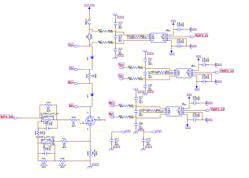

I have 16 channels of the same circuit shown below.
I have positive and negative power supplies ( 15V,-15V, 1A, TI LDOs).
Can anybody tell me how to deal with power layout for the OP-AMPs if I use 4-layer (Signal-PWR_GND-Signal) PCB board?
Please show me your picture if you have.
Thank you!
I don't know how critical is your circuit, I am just giving you the most stringent way good enough for low RF and no huge current surge which I don't see you have any high current surge circuit.
1) put ground plane under components ( layer 2)so you have one continuous ground.
2) Put power on layer 3. It is vitally important the spacing between layer 2 and 3 has to be very small. Make it 5mils. This will form a distribute capacitance between the power and ground and make the power plane an AC ground.
3) Since you have to have cut on the power plane, put 0.01 cap from plane to ground at regular spacing along the cut. Make sure you put caps on both planes on each side of the cut and the caps are going in pairs on each side of the cut(one on each power plane). This will ensure the ground current has uninterrupted path so it does not have to go around to search for the return path.
4) put 0.01 cap on the plane in the area with a lot of signal traces vias from top to bottom layer.
With the caps pairs and close spacing power and ground plane, I literally mend the cut on the power plane and make it one complete plane through the distributed cap and the pairs of caps along the cut. How far apart each pair spacing along the cut depends on the highest frequency you are operating. If you are working into like 50MHz or higher, one pair every inch or so will be more than enough. The larger cap is not critical as long as you have enough.

Sorry for the missing information. It's a low frequency case rather than a RF one. I put decoupling capacitances right next to each supply pin of OP AMPs.
These OP-Amps uses dual supplies (+15 and -15 Volts with common analog ground). To make sure the power supply connection is short, should I put these negative power pins of OP-AMPs on the -15V power plane and the positive pins on the +15V power plane if I use Sig-GND-PWR-Sig PCB board?

yungman,
His component selection suggests it's unlikely that the frequency of the application is high and the schematic suggests the physical size of the PCB will be small, so I'm not sure he'll see much benefit from tight coupling between the the gnd and power planes.
In fact, I'd recommend doing the opposite: place the gnd plane (layer 2) close to layer 1 and, by symmetry, the power plane close to layer 4. This will reduce the signal loop areas and, as an added benefit, also reduce the required (microstrip) trace width if he's planning on controlling the trace impedance on those differential inputs. I'd then route anything critical on layer 1 and sleep well knowing that I had an uninterrupted low impedance return path in the solid gnd plane on layer 2.

dayusimon,
I'm wondering if the responses so far (mine included) have been a bit overly enthusiastic. In an attempt to be more useful: yes, you connect the opamp +/-15V supply pins to the (split) power plane on layer 3. You have the right idea with the decoupling cap. And don't worry about the stackup, it will probably not be the defining factor of how well this circuit will work.

Yes , actually I planned to place the GND (2nd) layer closer to 1st layer. Those critical signals will be placed on 1st layer.
The component placement annoyed me much since there are so many of them. I guess I have to use wide power traces instead of split power planes on the PWR plane since there are 16 channels and I cannot place all the components into two split planes properly and compactly. Will that be ok?
Another question is, the power distribution will be a multipoint type which is said to be a bad practice by some guidelines. I don't know how badly it will affect the circuit.
Regardless of frequency, it is important to have power plane tightly couple within reason. You avoid a lot of noise problem doing that. Noise happen if the return ground current gets interrupted. Even at low frequency, the ground current ( called the image current) follow closely to signal forward current, if you have a signal trace on the bottom layer and cross between the two power plane, the ground current path got cut and has to find a round about way to complete the loop. Magnetic field form when a current form a loop, the bigger the loop, the stronger the magnetic field that can induce emf into other circuit. This is important and that's the reason boards don't pass emission test.
Noise is not exactly a problem when the signals are running on the same layer without via to the bottom. It is always when the via that connects the signal from one layer to a different layer, then you really have to worry about the disruption of the image current. This board has 16 channel, it's going to be a sizable board.
If you running a few KHz, then it is not important, but if you even running 100KHz, it is advisable to pay attention to this.
But of cause, I am very conservative in pcb layout and I am known to overkill. So take this into consideration too.

Using power trace is fine. In a certain way, it is better because you don't have a cut plane . Now you have only one ground plane, there should be no image current Make sure you have 0.1uF bypass cap very close to the power input of the opamp to the ground.
What is a multi point distribution, I am not familiar with this name. Ideal is to have power input at one point, then star out and each trace goes to one section of the circuit, so you have 16. But in real world, it can be hard. I can't read the detail of the circuit, I don't know exactly what the circuit is doing, so it is hard to give detail advice. Do you have any high current device? Do you have any high speed device?
I downloaded the schematic so I can enlarge it to see the detail, the image is still too blur to even see the part number of some. But I can see the opamp part the you are using 10M resistor on one and 190K as feedback resistor on the other.
You have high gain in the circuit as you have one opamp running open loop and the second opamp has gain of 20 to form the closed loop feedback circuit AND the value of the resistance are too too high. 190K and 10K, that is gain of 20, you can use 19K and 1K. The higher the impedance of the opamp circuit, the more it is susceptible to emission noise.
You have 16 channel, if you try to use power plane, the cutting is going to be very complicated and difficult. If you don't follow my precaution, you are going to create more noise. This compound with your high gain and high impedance circuit. Yes you are not running at any high frequency, but you have a lot of gain.
My suggestion is, forget the cut power plane, you can make it worst. Star out power trace at one point and each go to one section. You might want to consider putting a small resistor in series from the power trace to the opamp and put 0.1 cap from the power pin of the opamp to ground. With high gain, you need to worry about cross talk on the power trace.
I can't see the part number of the circuit on the right side, I don't know what it is so I can't even comment on that. Just the opamp on the left already bring your circuit into more critical category.

At 5 mil (0.127 mm) separation the inter-plane capacitance is about 30pF/cm^2. The effective interplane capacitance, however, is dependent on how fast a consuming IC needs charge. E.g., a digital circuit (which he doesn't have, but it serves well to illustrate the point I think) with a rise time of 1 ns would presumably need charge during that entire t=1ns interval, so all charge located further away from the IC than a radius of
r = c*t = (0.3 m/ns) / √εr * t = 0.3 m / √εr = 14 cm
would effectively be useless because it wouldn't reach the IC in time. In light of that I think my argument about small physical size is probably wrong.
But let's say his PCB ends up being 10cm^2 and that all of this area makes an effective capacitor, then this would still only represent 3nF. This value is too small for effective low frequency decoupling, so typical 100nF caps must be used in any case, and so the 3nF is comparably small and insignificant.
Therefor, for a low frequency four layer board, the small benefit you get by squeezing gnd and power (layer 3) together is by far outweighed by the upside of placing the gnd plane (layer 2) close to layer 1, mainly tight gnd-to-signal trace coupling (reduced gnd plane inductance, reduced crosstalk, etc) and reduced signal loop areas (reduced diff mode radiation, etc).
Does that makes sense?

With high gain, you need to worry about cross talk on the power traces.
I'd say crosstalk is a reason for tight coupling between signal layer 1 and gnd layer 2. The crosstalk between two signals is proportional to the square of their distance to the adjacent plane, so reducing the L1-L2 separation from 29mil* to 5mil would reduce crosstalk on a signal pair by 30dB.
*1.6mm PCB = 63 mil, 5 mil L2-L3 separation => L1-L2 and L3-L4 separation = (63-5)/2 = 29 mil

I decoded that to be an opamp (AD8227), can't you tell from the symbol in the schematics? ;)

7) It sure don't look like opamp symbol and the circuit don't look like a simple opamp circuit.
I was making a joke at the expense of whoever drew that symbol, and at the same time I was telling you that the device in question is AD8227.
I KNOW WHAT YOU TOLD ME! I said this is a post for layout, not a circuit. I am not going to spend effort to study the circuit deeply and I was not going to comment on that part. The post is question about power routing.
