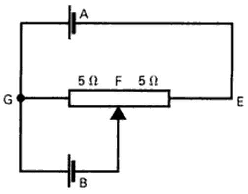

In the following circuit, cell A has an EMF of 10 V and an internal resistance of 2 Ω; cell B has an EMF of 3 V and an internal resistance of 3 Ω.
(a) Show that the currents through A and B are 65 / 71 amps and 14 / 71 amps respectively. What is the magnitude of the current through GF?
(b) Determine the power dissipated as heat in the resistor FE. If the circuit is switched on for 30 minutes, calculate the energy dissipated in FE in kilowatt-hours.
(c) What is the potential difference (i) across the terminals of cell A, (ii) across the terminals of cell B?
(d) Calculate the rate at which energy is being supplied (or absorbed) by cells A and B.
(e) If the contact F can be moved along the resistor GE, find the value of the resistance GF when no current is flowing through cell B.
(f) At what setting of F would cell B (i) be discharging at the maximum possible rate and (ii) be charging at the maximum possible rate?
Answers: (a) 0.718 A, (b) 4.19 W, 2.095 * 10-3 kWh, (c) 8.17 V, 3.59 V, (d) 9.15 W, 0.592 W, (e) 3.60 Ω.
2. The attempt at a solution
(a) 10 - 5 (I1 - I3) - 5 I1 - 2 I1 = 0 → I3 = 2.4 I1 - 2. Plug into: -3 -3 I3 + 5 I1 - 5 I3 = 0 → I1 = 0.9155 A (65 / 71), I3 = 0.197 A and I2 = 0.718 A.
(b) P = V I and V = R I = 5 * (65 / 71) = 4.6 V. Then P = 4.6 * (65 / 71) = 4.19 W.
W = V I t = 4.6 * (65 / 71) * (30 * 60) = 7543 J. 1 kWh = 3.6 * 106 J so 7543 / 3.6 * 106 = 2.095 * 10-3 kWh.
(c) This is where difficulties come. As I understand, I should calculate the voltage of the circuits. (i) V = I R = (65 / 71) * (5 + 2) = 6.4 V of the 5 Ω and 2 Ω resistors around A. (ii) We calculte the voltage of the 3 Ω resistor: V = (14 / 71) * 3 = 0.59 V plus 3 V is 3.59 V for the 5 Ω resistor since it is parallel.
I didn't continue since I am not sure on (c). What's wrong with it?

Hm, in that case I get a correct answer for (i) and a wrong one for (ii) o_O.
I did a drawing for (a) and (b) and in my drawing a have current going from A to the left and then entering B from the left and then current enters A from the right. So in terms of B we have + 3 V - ... + 3 Ω - and so we have PD = EMF + I r. And in A we have + 10 V - ... - 2 Ω + and so we PD = EMF - I r.
I think this is the correct reason...

You need to consider the directions of the currents. What is the direction of the current through B? Terminal voltage of B is greater than the emf.
Yes. That's the reason. Good job!

If no current is flowing through cell B then all current is flowing through the GF resistor. And then we have R = V / I = 3.59 V / (65 / 71) = 3.92 Ω.
By moving the slider on the variable resistor (also known as a potentiometer), you're changing the circuit. So the old values of current and potential differences no longer hold. You need to re-evaluate the circuit for the new conditions.
Since you're looking for conditions where cell B has zero current flowing, start by imagining that the lower cell is not connected at F (open that connection temporarily). This will let you evaluate what will be going on in the upper loop under those conditions. What then is the current in the upper loop?
I3 = 0 so 10 - 5 (I1 - I3) - 5 I1 - 2 I1 = 0 so I1 = 0.833 A.
And then 10 - 0.83 R - 5 * 0.83 - 2 * 0.83 = 0 so R = 5 Ω.

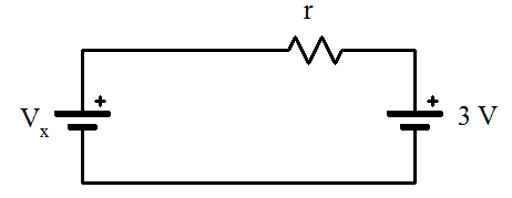

moenste said:
We can't find the PD between G and F. We need to know the resistance to find it.
That's not true. You can specify the potential difference first, then calculate the required resistance. What potential difference will prevent current from flowing in the bottom loop?
Consider the following example where you have a known battery of 3 V with some internal resistance, and some other (unknown) potential difference source:
What must ##V_x## be to prevent current from flowing in the loop?
I think you are suggesting this (maybe you missed it, I updated the post later):
moenste said:
Update:
-3 - 3 * 0 + 0.83 R1 = 0
R1 = 3.6 Ω
It gets the corect answer. But how can we consider it, since the whole GBF line is zero?
It works because if the bottom loop has no current flowing then the upper loop is effectively isolated and its current is fixed solely by the resistance in its path: the internal resistance of the 10 V battery and the 10 Ohms of the potentiometer. Then you simply need to find the potential difference across R1 that makes your equation true. R1 has the upper loop's current running through it all alone, since the lower loop is contributing no current.
The situation in the example in post #22 shows what potential difference is required to prevent current flow.
What must VxV_x be to prevent current from flowing in the loop?
VX - Ir - 3 = 0
VX = 3 V since I = 0.

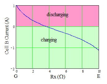

For the (f) part we need to find the position of F or in other words the resistances of the GF and FE parts right? But what is the correlation between the discharging and charging at the max. possible rates and the resistance?
That you'll have to determine. What do you think is implied by maximum charging and maximum discharging? How does a battery charge or discharge?
We had that topic in a different thread. I hope I got it right: a battery charges if it's current is going like - V is larger + ... + V is lower -. So the second battery is charging from the first one since it is pushing current to the second battery. And they are discharging if - V + ... - V +. In that case they work together and push current together.
Okay, so discharging means current is flowing out of the + terminals of the battery, charging means current is flowing into the + terminal of the battery. Now you have to ponder how to maximize each of those with the given circuit. Remember, the only thing you can adjust is the position of the tap F on the potentiometer.
