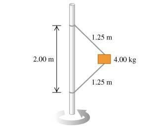

The 4.00kg block in the figure (Intro 1 figure) is attached to a vertical rod by means of two strings. When the system rotates about the axis of the rod, the strings are extended as shown in the diagram and the tension in the upper string is 82.0 N.
Diagram of a vertical rod with a 4.00 kg block hung from it by two strings, one upper and one lower, each 1.25 m long; the rod is 2.00 m between its attachment points, and a curved arrow at the base shows rotation about the rod's axis.
a) What is the tension in the lower cord?
b) How many revolutions per minute does the system make?
c) Find the number of revolutions per minute at which the lower cord just goes slack.
a) I need to focus on the y-component so..
T1 cos[tex]\theta[/tex] - T2 cos[tex]\theta[/tex] - mg = 0
I find [tex]\theta[/tex] by taking the triangle formed by the rod and two strings...
Diagram of an orange block hung by two strings from a horizontal rod, each string 1.25 m long, with a horizontal separation of 1.00 m between attachment points and 2.00 m overall along the rod, with a curved rotation arrow.
cos[tex]\theta[/tex] = 1/1.25
With all this info.. I can find T2. Correct?
b) I know the formula for T is T = (2[tex]\pi[/tex]r) / V... or T = 2[tex]\pi[/tex]*[(Lcos[tex]\theta[/tex])/g]^1/2
Do I actually use this formula? I am a bit confused since later I have to find T when the lower cord slacks. Can someone clear this up for me? :smile:
limekiwi said:
a) ... With all this info.. I can find T2. Correct?
Yes, correct.
What equation involves force and circular motion?
