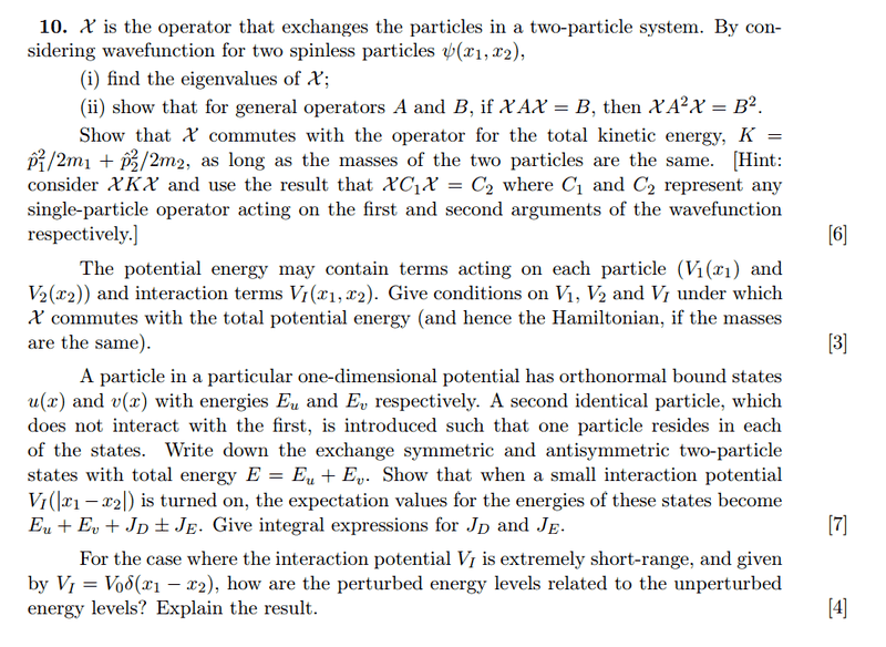

Perturbation Theory, exchange operator
unscientific
1,728
Part (a): Find eigenvalues of X, show general relation of X and show X commutes with KE.
Part (b): Give conditions on V1, V2 and VI for X to commute with them.
Part (c): Write symmetric and antisymmetric wavefunctions. Find energies JD and JE.
Part (d): How are unperturbed and perturbed energy levels related?
