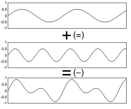

When you add signals with different frequences, at some moments of time their total amplitude will be greater and at some - smaller
When difference in the frequences is small, most of the time, total amplitude will be greater.
When you add mass, you change the ressonant frequency and maybe the two frequences get near to each other and there is a greater total amplitude.

Thanks very much for being the first to reply to my query. While the information you have given me does not give a quick and simple answer to my :problem", I now realize that this is more complex situation than I had thought originally. I printed off your reply, and the entire thread : The Frequency Domain... As usual for me, a lack of higher math prevents me from understanding the article fully, I did get a general idea as to how sine waves affect each other.
In the case of sine waves generated by guitar strings, as compared to the sine waves generated by an electric guitars resonance, I believe that the string frequency amplitude, would have to be much larger than even THE resonant frequency of a particular electric guitar's neck/body.
I am now left to wonder how much the variation of an electric guitar's wooden components, structural design, and even finish, would affect the guitar's neck/body resonance. This especially in the sudden thought. that such construction parameter may very well affect the resonance of the guitar's strings as well.
