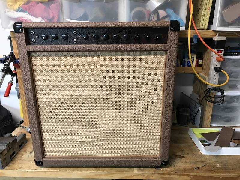

Hi Guys,
This was my first attempt at trying to make a case and covering it. I made a few mistakes and learned a good bit about the process. I think I learned enough to do a good job on the next one. Education is never cheap...lol
The amp is basically a AB763 with a few mods. The current speakers are two Celestion vintage G12M from the 1980s. I ordered Weber D12 and also Weber NeoMag to experiment with. The NeoMag is Weber's take on a JBL D120F. They should be here is a week or two.
The reverb is still producing more noise when it is turned up than I am happy with. Other than that the amp only starts to produce a very small amount of hum/hiss when the volume is turned up past 90%. I am not sure just how to reduce the reverb noise.
I had no idea when I started these amp building projects how many hard to acquire skills sets were involved. I think lack of precise planning has caused the greatest number of issues. We live in a world of specialization. Perhaps my attempts to "do it all" myself is a very steep mountain to climb.

Looks like your case came out nice and I;m sure you'll figure out the electronics issue too.

Looks very nice. Well done.
I am about to start on a 5E3 Deluxe clone. It is my first kit and I bought a pre-loaded turret board to reduce the opportunity for cock-ups. It is going in a Laney AOR30 shell so I already have the transformers and 6V6 output valves. Sounds easy...

The 5E3 is fun to build. It is a bit tight inside the chassis. Try to find a 3 watt 5000 ohm dropping resistor. The ones that come in kits are sometimes only 2 watts. The original Fender schematics showed a 5 watt.
