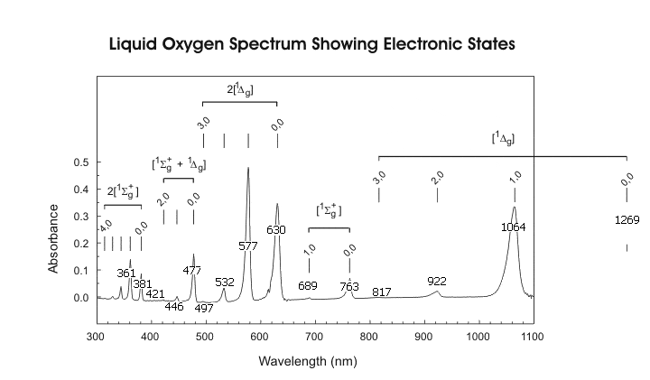

I guess I need to be more specific, I'm wondering about the following:
Say I have all the wavelengths below from 1269-381 nm. What wavelengths would I need to excite the liquid oxygen to it's highest possible energy?
What wavelengths would not be needed?
