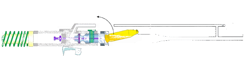

In this post I want to address some very controversial issues among the professional sport shooting world, and try to answer these questions with basic physics. Bear with me as it does require some introduction!
Below is an animation of the gas impingement system typical of a modern semi-automatic rifle:
http://209.200.109.169/arfcom/gasimpingement.gif (animation)
For those not familiar:
1) The spring on the left is the "buffer spring"
2) The reciprocating mass consists of the Bolt Carrier Group (BCG) is the gray thing as well as the Buffer (the yellow part in the spring)
3) There is often an adjustable valve that controls how much gas is allowed back into the system to reciprocate the BCG.
In modern professional 3-gun competitions, the standard practice to reduce felt recoil during rapid firing is to do the following things:
1) Reduce the internal reciprocating mass (BCG and Buffer) by as much as 50%
2) Because reciprocating mass is now lower, also reduce the flow of gas from the adjustable gas block so that the BCG reciprocates at approximately the same speed as originally.
3) Because reciprocating mass is now lower, also reduce the buffer spring tension so that BCG returns to battery at approximately the same speed as originally.
The conventional wisdom or explanation for these changes is that by reducing the internal reciprocating mass, the overall felt recoil of the gun will be less. The fact that by restricting the gas port, more of the gas pressure will exit from the barrel of the gun rather than being directed back through the impingement system, is typically ignored -- though I don't think that's a safe assumption (more on that later).
If one consider the imaginary limit in which one continuously reduces the weight of the reciprocating mass, you eventually end up with a rifle that has no reciprocating mass -- in other words, a bolt action rifle. It is widely agreed that a bolt action rifle has larger felt recoil than a semi-auto rifle. The physics explanation is that the reciprocating action of the BCG absorbs some of the momentum. In other words, the momentum of the reciprocating mass is subtracted from the momentum of the ejected bullet+gas to get at the remaining felt recoil.
At this point, it is tempting to conclude that the professional 3-gun shooters are full of BS. The fact they have a lower reciprocating mass necessarily means that their guns must have more felt recoil. Or does it?
This is not quite the end of the story, because It is standard practice to put a compensator at the end of the barrel, which is basically a series of open-air baffles that reflect as much of the gasses coming out of the barrel back in the direction of the shooter as possible, with a hole just barely large enough to allow the bullet to continue moving forward. It has been found that an effective compensator can reduce overall linear motion of the rifle by as much as about 75%.
So, while it is true that a rifle with low reciprocating mass will have less rearward momentum from the movement of internal parts, it will have MORE gas pressure reflected back towards the shooter at the end of the barrel by the compensator.
At this point, my arm-chair analysis of the problem escapes me. I'm not sure how effective recoil mitigation in the form of reflected gas pressure would be in comparison to reciprocating mass. I'm interested in trying to get a better understanding of this question from an intuitive/theoretical (arm-chair) perspective...but how to even begin?

For simplicity, let's assume that the compensator is 100% effective. In other words, 100% of the excess gas coming out of the muzzle will be reflected straight back at the shooter.
Before reaching the end of the barrel, some fraction of the gas is redirected via the gas tube back in the direction of the shooter -- and this is used to push the BCG. According to the law of conservation of momentum, the rearward force of any gas used to push the BCG must be equal to the force of the BCG itself. Either way, this is force that's NOT being applied to the gun.
Thus, it seems that the net recoil force of the gun must be equal to the force of the bullet, minus the force of any excess gas not used to power the bullet...and entirely unaffected by mass of the BCG. The only effect that changing the mass of the BCG would have is changing the fraction of rearward force that was due to reciprocating BCG vs. rearward gas pressure.
So..does this mean that using a lightweight BCG has NO EFFECT on recoil?
No...because the above is neglecting any timing information. In reality, there is going to be some initial rearward recoil force applied to the gun equal to the total amount of gas force...then the recoil force will be somewhat reduced by the force of gas that enters the gas block and reverse direction...and then reduced more significantly when the gas at the muzzle reflects back off the compensator baffles...and again reduced when the BCG finally starts moving rearward.
Because the BCG is the last thing to move rearward, using a heavier BCG effectively means that you have to wait longer before recoil of the gun starts being counteracted. Or in the other words, the lighter the BCG is, the more gas will be quickly reflected back at the compensator, which means that the felt recoil impulse of the gun will last for a shorter duration of time.
A complicating factor is that the reduced recoil might just reflect a reduced bullet velocity. It seems as though a very light BCG might do that. For a fair comparison, suppose the bullet velocity is a constant. Then conservation of momentum says that the backward momentum equals the forward momentum of the bullet and gas combination. So the only variables would be in how the gas is directed and the time profile of the recoil force.
So it seems to me that the only effects would be due to one of 3 variables (or a combination of them):
1) Decreased bullet velocity
2) Redirection of the gas
3) The time profile of the recoil force.

Here is a more complete animation:
As you can see here, the BCG doesn't even start moving until after the bullet has left the barrel -- so the weight of the BCG cannot possibly have an effect on muzzle velocity directly. If anything, a lightweight BCG would increase bullet velocity by a very small factor, because one would typically reduce the amount of gas that is redirected for cycling the BCG, resulting in slightly higher gas pressure for the last few inches of the barrel.

Good question! That is the "rotating bolt" -- basically, the bolt has a bunch of locking teeth on it that slip through matching teeth on the back of the barrel. At the very end of its travel, it is forced to rotate so that the teeth are locked into the barrel. This prevents the bolt from recoiling and presents a solid surface for the gasses to push off from. You can better see from this animation here:
That seems to leave us with the principle of conservation of momentum. I can only think that the recoil might seem different because of a different force time profile. But one way or another, conservation of momentum must apply.
Yes, conservation of momentum must apply...and if we assume that the compensator is 100% efficient, then what this means is that the final forward momentum of the bullet must be equal to the final rearward momentum of the gun, excess gasses, and BCG.
However, I've had another epiphany...
In my previous post, I argued that it made no difference (other than time) if rearward momentum was conveyed through the BCG vs. excess gasses. However, upon further consideration, any rearward momentum that is initially absorbed by the BCG will then be transferred into the recoil spring, and then released from the recoil spring...giving all this forward momentum back to the BCG, and giving an equal amount of momentum rearward in the gun itself.
So in other words, when momentum is transferred to the BCG, this results in a delayed counter-recoil of the gun, followed by an even more delayed giving back of recoil to the gun in the original amount. In other words, any momentum initially taken up by the BCG doesn't reduce the net rearward momentum of the firearm one iota. In contrast, momentum that is put into rearward gas pressure is a permanent reduction in the final rearward momentum of the gun...so by using a lighter weight BCG, we funnel more gas down the barrel, hence more gas is reflected by the compensator, hence the final rearward momentum of the gun itself is reduced.
Impulse force is the change in momentum over time, so if we've concluded that the lower BCG configuration results in less rearward final momentum, then by definition the "impulse force" (aka recoil) of the gun over the recoil duration is reduced.
