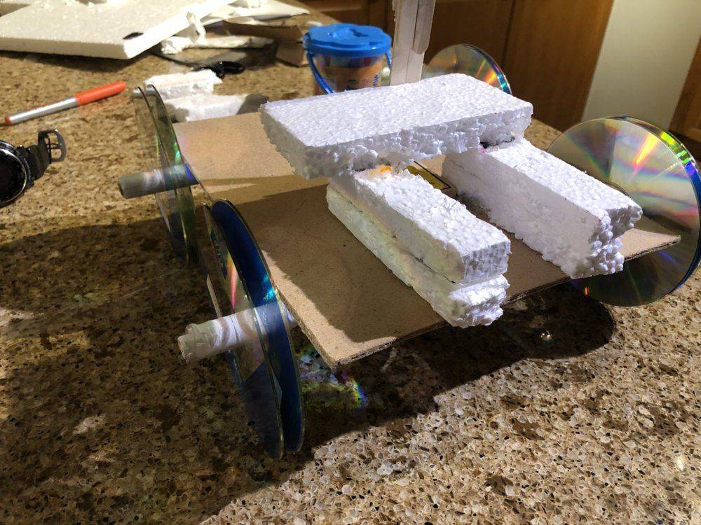

I just built a prototype, although the issue is the mouse trap catapult doesn't seem to be strong enough to propel the car 6m. I am thinking of just buying a bigger mouse trap, but that will for sure increase the weight of the car. So do you have anything suggestions on what else I might be able to do?
