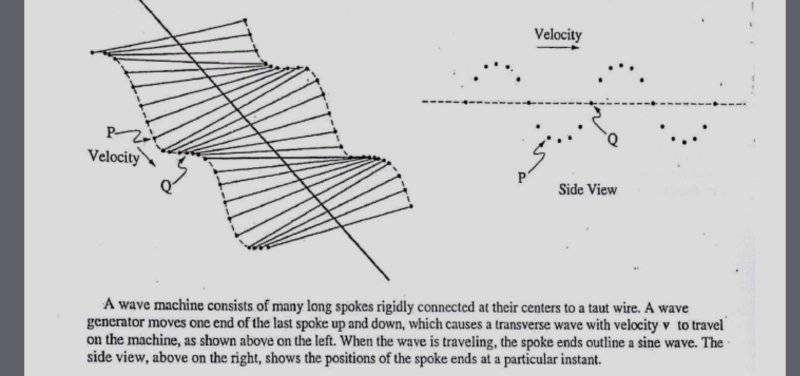

the question asks at which point is the string moving upward at the instant shown?
No equations needed
I am not sure how I should approach this type of questions.
A) will move downward
B) downward then upward
C) upward then downward
D) same as C
E)upward then downward
Am I correct?
Here I think its clear that spoke P will move up, but Q will move up then down. Answer is A so Q will move down. Should I approach the question above the same as this one?

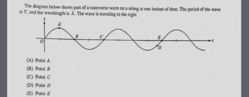

The upward direction is the direction of the y ^ arrow , -if you simply start at the left 0 and follow
the string with a pen top you will find there are TWO of the points from the A-B-C-D-E list of shown points
where where your pen top is traveling upward in the general direction of y ^.
So, you’re saying it could be C and E,right?
I understand now that pointing away from the x-axis means upward and pointing toward the x-axis means downward,yes?
y^ is upward above 0 , y ∨ [downward arrow] below 0 is , of course, downward. By convention (Cartesian axes) y^ is usually
only given.
For representing waveforms / "string" , negative numbers of y ( ∨ or y below 0 ) are not that important -for SATS anyway-
The amplitude of the waveform ,or maximum distance from the horizontal x axis, can be taken at the turning point ("crest")
above the x-axis , namely point A. [ since below is a mirror image in the question]
Sorry, my bad, I overlooked D aswell. Your pen top will be traveling upward [ direction y^] at that point as well.

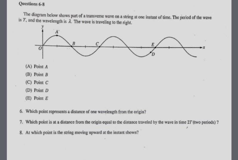

Here is it in full. I actually solved it as D before posting this. Can we say that points C and E are the nodes so at this instant they’re neither up or down?

Q6 one wavelength = two 'loops' . Answer?
Answer C
Correct. Question 7 isn't in the English language.
Q 8 Hint Forget about nodes. D is correct, but is your pen top going upward at any any other points aswell?
7 asks about twice the period, so E
Pen top points upward at 3 points as you said earlier..
