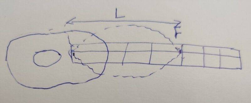

(a) How does plucking a taut string of a guitar produce sound?
(b) How can the same taut string of a guitar produce sounds of different frequencies?
(c) Does a taut string of a guitar always produce the fundamental mode i.e. the distance between where the finger presses the taut string ( one fixed end) and the other fixed end is always ##\frac {\lambda} {2}##? I am wondering how the first overtone, second overtone etc. can be produced on a single taut string of the guitar, or maybe only the fundamental mode is possible.

For b, when you press the fret board with your finger what changes?
A visual of the fundamental mode will help you answer c. Picture the string as the wave.

The length ##L## mentioned in third equation i.e. the length of vibrating string changes ( decreased compared to string's orginal length).
I can picture the fundamental mode for length ##L##, but how can I explain how the first overtone, second overtone etc. are created provided they are possible?
Below is a rough sketch of the fundamental mode, if the taut wire is pressed at point F and then plucked between F and the fixed end on guitar's body.

For part (c) you need to understand that when a string is plucked, it is deformed from straight and then released. Just before release, its shape is not half a sine as shown in post #3. More likely, it is some kind of triangular shape which can be reproduced mathematically as a superposition of sines. This is done by writing the initial shape of the waveform ##y(x,0)##, as $$y(x,0)=\sum_{n=1}^{\infty}a_n\sin\left(\frac{n\pi x}{L}\right).$$Note that this expression is zero at the two ends of the string, ##x=0## and ##x=L## as it should be. The coefficients ##a_n## can be found if one knows the initial waveform but let's not worry about that now. All you need to know is that they get progressively smaller as ##n## gets larger.
Because this is a homework problem, I leave it up to you to explain why this means that you get overtones and not only the fundamental.

There is no interference, just many standing waves each doing its own thing with its own amplitude which could go on forever if there is no loss of energy. It's the other way around. You start with a superposition of wavelengths which set the frequencies that are multiples of the fundamental. For a fixed length ##L##, you have multiples of half integer wavelengths. Thus
n = 1 gives ##~1\times\frac{\lambda}{2}=L\implies \lambda_1 =\frac{2}{1}L##
n = 2 gives ##~2\times\frac{\lambda}{2}=L\implies \lambda_2 =\frac{2}{2}L##
n = 3 gives ##~3\times\frac{\lambda}{2}=L\implies \lambda_3 =\frac{2}{3}L##
n = k gives ##~k\times\frac{\lambda}{2}=L\implies \lambda_k =\frac{2}{k}L##
For the same speed of propagation ##v=\lambda~f##, different wavelengths correspond to different frequencies.
