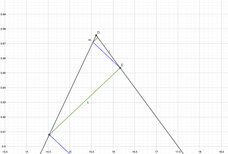

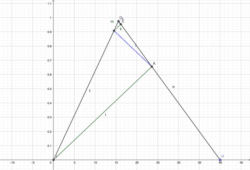

I tried the geometric approach. Seems to work but my precision wasn't enough to get the same answer beyond three decimals. I get XX.XXX69 vs. XX.XXX95. Edit: I fixed it so they now match to high precision. Time is the vertical axis in hours and distance is the horizontal axis in ##km##.
