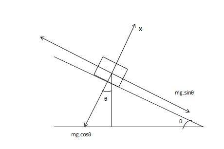

A block of mass M is released from point P on a rough inclined
plane with inclination angle θ, shown in the figure below. The coeffucient
of friction is μ. if μ < tan θ, then time taken by the block to reach another
point Q on the inclined plane, where PQ = s, is
What is the meaning of " PQ = s" in the question?
How ##t = \large\sqrt\frac{2s}{a} ##?
Sol:
246603
##Mg.sinθ - μMg.cosθ = ma##
##a = g.sinθ - μg.cosθ##
Now ##S = ut + \large\frac{1}{2}\normalsize at^{2}##
but ##u = 0##
##t = \large\sqrt\frac{2s}{a} = \sqrt\frac {2s}{gcosθ(tanθ- μ)}##
My questions:
How ##a =gcosθ(tanθ- μ) ## in that last square root step?
s=a/2 t^2 is a standard formula, that's how he got a=sqrt (...)
a=g(sin theta - mu * cos theta) just comes from considering forces parallel and perpendicular to the plane where it slides. PQ=s just means that instead of always writing "PQ" he will write "s" because its shorter.
Explain this equation ##Mg.sinθ - μMg.cosθ = ma## ? I know standard sliding block equation: ##w·sinθ – μkN = 0## &
##N – w·cosθ = 0##How to understand ##μ < tan θ##?

Yes you just take N=W cos theta and put it into te standard sliding block equation. Then you immediately get what you want
mu<tan(theta) because otherwise the block won't start sliding, the friction holds it in place. You can see that the equation of t=sqrt (...) gives you a complex number
Benjamin_harsh said:
I know standard sliding block equation: w⋅sinθ–μkN=0w·sinθ – μkN = 0
This equation is not standard for a block sliding down an incline with only gravity and incline forces acting on it. It is correct only if the acceleration of the block along the incline is zero.

The general form for the two equations that is always correct to write down is
## ΣF_{x} = ma_x~;~ ~ΣF_{y} = ma_y## where ##a_x## and ##a_y## are the components of the acceleration. The sum of the forces in either direction is zero only if you have good reason to believe that it is. In this particular problem you have a block sliding down the incline along the ##y##-axis. This is enough reason to know something about the acceleration in the ##x##-direction. What is that? You are also told that the coefficient of (static) friction is less than ##\tan\theta.## That says something about the acceleration in the ##y##-direction. What could that be? Hint: What is the statement of the problem trying to tell you with ##\mu<\tan\theta##?

The net force in either direction is zero if the acceleration in that direction is zero. Of the two directions, perpendicular and parallel to the incline, is there a direction along which you can tell for sure that the acceleration is zero and hence the net force is also zero? Hint: Acceleration is a measure of change in velocity.

Acceleration if no friction exist; ##a_{x} = mg.sinθ##
Acceleration if friction exist; ##a = g.sinθ - µ_{k}.g.cosθ## (I am not sure whether it is ##μ_{s}## or ##µ_{k}## in this equation)
Are these equations correct for sliding block equations?

Incorrect. There should be ##m## on the right side.
This is correct but only if the gravity and the incline exert forces on the block. You should use ##\mu_k## if the block is moving relative to the surface. You may use ##\mu_s## in that equation if the block is at rest relative to the surface but only if the block is just on the verge to start sliding.

They are correct but subject to the conditions stated above for the direction parallel to the surface. What about the direction perpendicular to the surface? What can you say about that?
