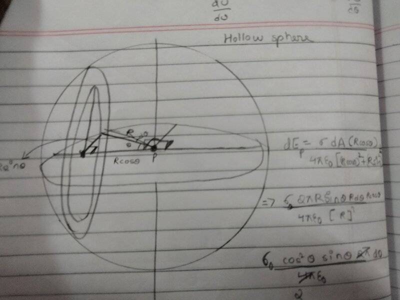

Theres a hollow sphere whose ## \sigma ## = ## \sigma_0 cos \theta ## where ##\theta ## is the polar angle/THE angle made with the x axis. Find field inside shell.
Expression of electric field on axis due to a uniformly charged ring = $$ \frac { Q z } { 4π \epsilon (R²+ z²)^{3/2} }
$$ where z is distance of the point from the center of the ring on the axis and R us the radius of the ring.
So I tried it out by taking a patch of area da at an angle theta from the x axis and rotating it around the axis, this gives you a cone whose, locus is that of a uniformly charged ring since all of the area is at the same angle theta and the surface charge density varies with theta.
My solution :
I used integration by substitution therefore u=cos ##\theta##
Now this answer matches with the required answer

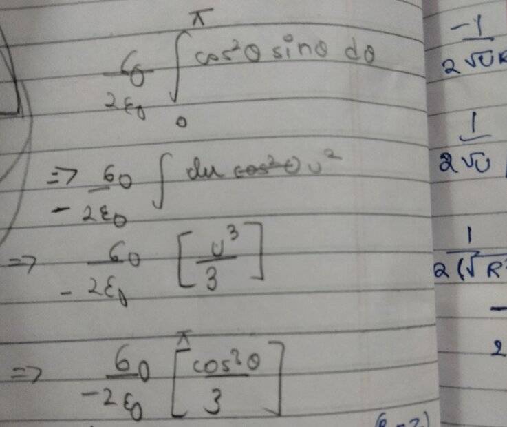

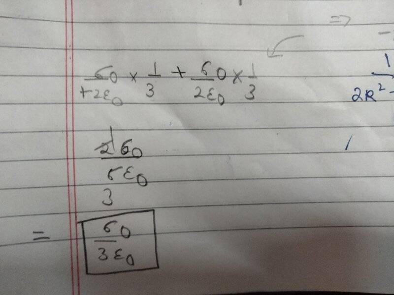

My solution :View attachment 345940

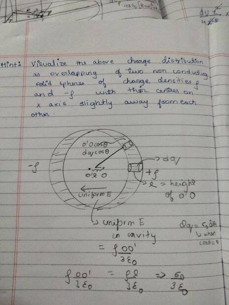

But the suggested solution was :View attachment 345943
Now im very lost in this suggested solution and I have some questions ....
From what I gathered they have taken two spheres of opposite charges and super imposed them on each other
1) How do they know that the charge is distributed like this? That half of it is negative and the other half is positive. ..
Couldn't it be some other distribution?
2) I have derived this formula for electric field in a cavity when the cavity was in a wholely positive sphere...doesnt the half negative and half positive distribution change the formula a bit?
Ive understood my First doubt..its merely the angle since cos theta becomes negative after 90°, the distribution becomes negative..the second doubt still somewhat remains

The two superimposed spheres are both uniformly charged. The field is the sum of their fields.

There are several possibilities depending on the level you start at. If you are familiar with vector addition and the field inside a uniformly charged sphere then you can use that. If you are more mathematically inclined you can solve Poisson’s equation to find the actual potential inside the sphere or solve the full integral for an arbitrary point.

Just do what they did in the suggested solution. Write down the field inside each of the uniformly charged spheres, then add them up.

So if you do the vector additions of the fields proportional to ##\vec x##, then yes you get the uniformity. I am just saying it because the full argument has not been presented in the thread. It would be useful to do so both for future readers as well as for having confirmation that you got it correct.
